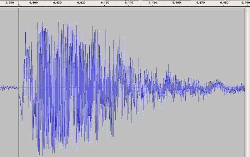

Just to show the flow of a QDV, this is the Audacity waveform showing 100ms of the sample recording. The sample is from 6.39 sec to 6.49 seconds of the recording. As you can see the entire discharge is pretty much completed in the 100 ms. This recording is of the 3 gallon tank with the 2 inch valve, quite considerably larger than the 3 liter pony tank in your launcher. Get a recording and compare performance.
EDIT, I added the MP3 of the tank valve test. Download the zip file and uncompress to play it. SF doesn't permit direct uploads of MP3 files.

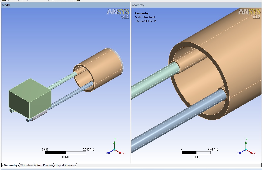

Nah it's easy enough to do...just has to be tuned properly...i like the idea of non contact braking just because its funky tech but i think its massive overkill tbh
For the piston im thinking some aluminium or titanium alloy or possibly structural plastic and this kind of shape...i can wrap the piston arms in springs and the block is meant to represent the damper. Once the piston clears the gap it makes contact with the springs and damper which bring it to a stop thus no kick back
EDIT: the first sentence sounded glib...apologies, i just meant that i have designed a 85kg centrifugal clutch before...the spings on that experienced 10s of kNs of force everytime the pads caught...by comparison its not so tough
