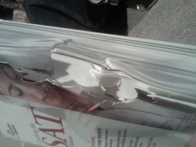

This is a damage pic of my SAT book.  At only 30 psi it tore through half the book, and this thing is really thick.

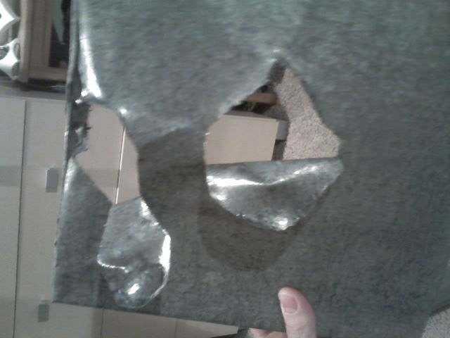

This is a damage pic of a piece of sheet metal.  This was done at only 15 psi.

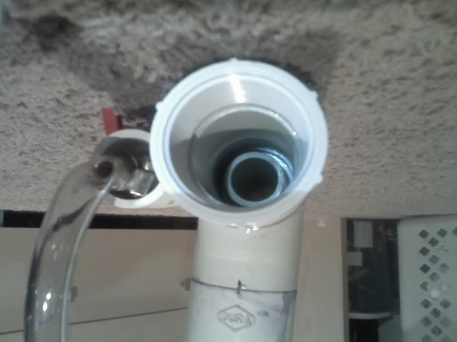

View of the serviceable piston.  Very convenient for lubing.

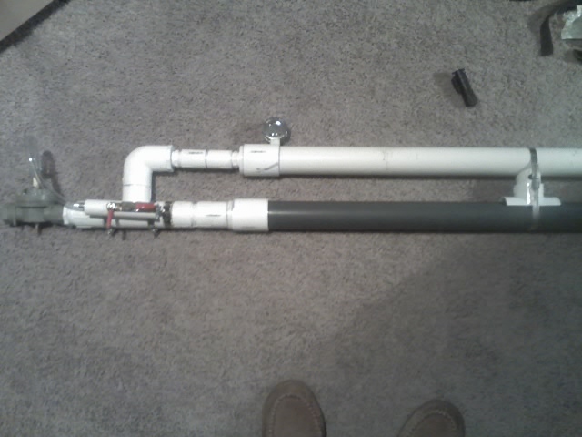

This is a view of the entire launcher.  I couldn't find 3" shc. 40 so I had to make a long 2" tank.

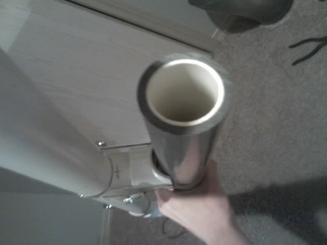

Golf ball barrel=DESTRUCTION

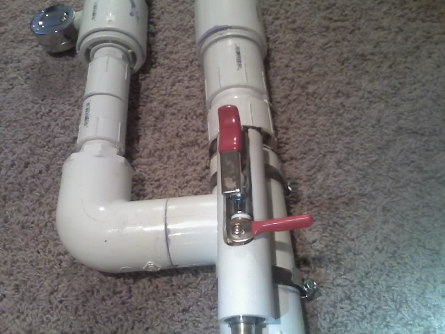

Closer view of the trigger assembly.

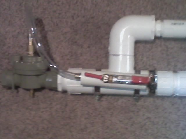

View of the back of the cannon.  You can see the trigger assembly here with the safety, and also the sprinkler valve.

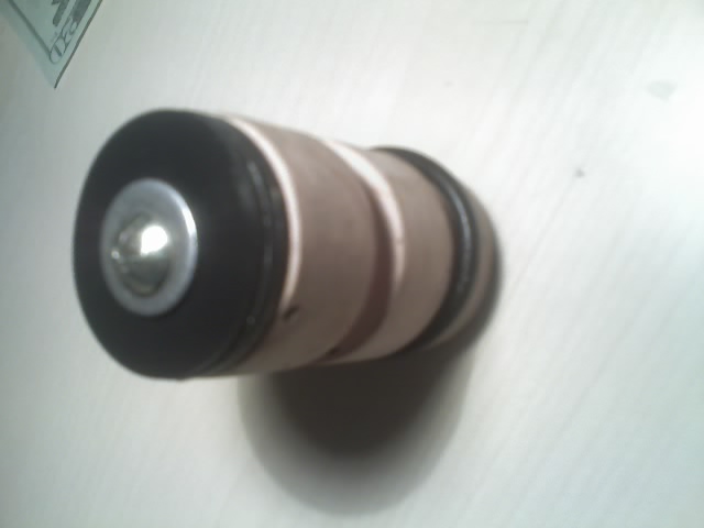

Here is the piston with the grooves for the o-rings.  I only ended up using one o-ring because the valve would not actuate with both of the o-rings.
Is there any reason for the skinny section of pipe between the chamber and piston valve? I would think that would limit power.
Nice job on the piston.
Looking good, but your chamber is bigger than your barrel? Your chamber could be cut off at the barrel support and I doubt you'd notice the difference.

The skinny section is because I already had that air tank from a previous launcher, and didn't want to make a new one. Yeah it is a big chamber. When I made that chamber, I didn't know that much about potato guns so I over-compensated I think. I also have a potato barrel for this cannon, and it's nice to have larger volume of air behind that fat spud.

Looks sweet, and some shooting vids would be a nice touch. I just want to say one thing though, with a gun like this, I think the sprinkler valve was a little overkill, the difference of performance between that and just a blowgun wouldn't be more than 30 FPS. As long as it's servicable though, it's good to know you can swap everything out.

I'd be interested to know how you calculated a 30fps difference between a sprinkler valve and no sprinkler valve...... :? Anyways it's probably overkill but it looks cool and dumps the air behind the piston wayyyyyyy faster than it really needs to.

You'd be wrong with the 30fps estimate by a very long shot.
It's all about speed, how fast the pilot valve can dump all the air. It's more like trying to push several hundred convicts out the prison gate instead of a hole in Andy Dufresne's cell wall.
I've had performance increase of around 30% over a blowgun and sprinkler valve. In fact, if you use a blowgun on a 2" piston valve that doesn't have o-rings and an average sized pilot volume , you'll be decreasing performance by a significant amount.
The minimum pilot valve for a 2" piston that doesn't have o-rings I would say is a 1/2" ball valve, and anything bigger than that is always better.
It depends a lot on the piston and pilot volume, but on average, I would say most 2" piston valves will barely open with a blowgun pilot valve, and a sprinkler valve could even double the performance.
GGDT gave me 163m/s for my golfball cannon with fairly accurate inputs from the top of my head. If I used a blowgun over a sprinkler valve, I get 69m/s, which as you can tell is a very, very significant difference.
Now, if your piston is o-ringed and your pilot volume that of a snickers bar, it wont make so much difference, but it'll still be definitely be worth it in my opinion to upgrade to a sprinkler valve.
