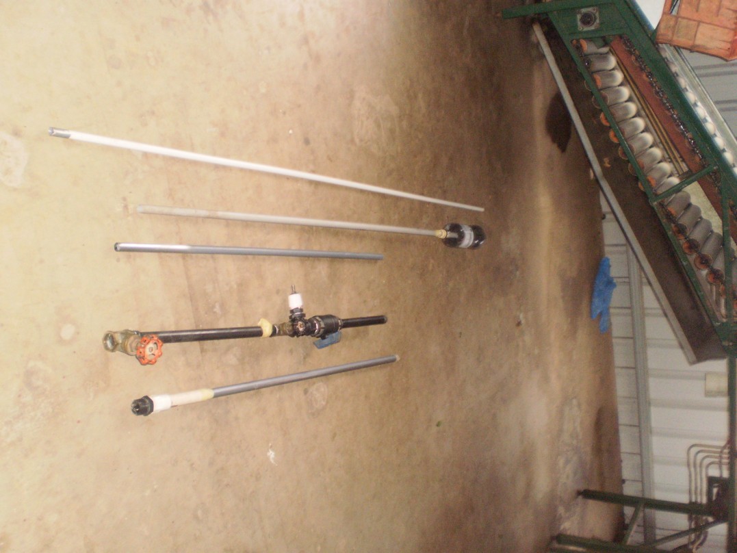

ok so heres a bit of an update to my 'bits n peices gun'. i have removed one of the gatevalves to loose the wheight a bit. also fixed the leaky ball valve by taking off the handle and replacing an o-ring in there, and found sum new barrels.
The white long one is a peice of 20mm conduit, i think its like 14-15mm id, its perfect for marbles, i added a silencer to the end, which actully really works well, it went from a crack sound to more like a shhwoomp sound.
The longer white one next to it is jst another curtain rod it sleeves inside the conduit to shoot, its bout 12 mm id, i only use darts in it.
My old barrel is there, its painted grey now, i only use it as a shotgun barrel now.
And the gray one on the right is off a cobweb broom, and the conduit sleeves in that jst to make it stable and not flopping around.
here the barrels, from left to right, 12mm id curtain rod, 20mm conduit, other curtain rod, the gun, and the support barrel for the conduit.
