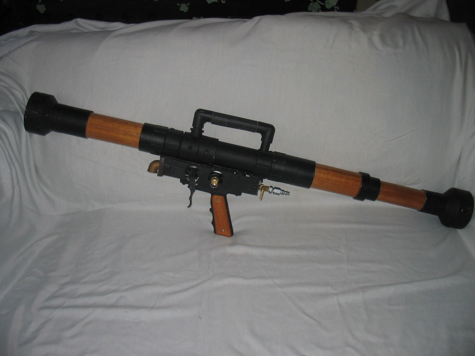

I have an Asco 12 volt valve available that could be converted to pneumatic control. If I recall without looking its 1 1/4" maybe 1" at the smallest. It you ask me though you may be going into more trouble then you need. I launch 8oz paint grenades with the RPG shown below over 200' at angles of less the 15 degrees and 16oz flour powered rockets 600' with vertical heights over 440'. It only uses a 1/2" port piston and costs less the $100 to build and has 3 barrels ranging from 1" to 2 1/2". If you want the Asco I'll get it out and send you the info. It came off a natural gas generator I replaced some years back.
