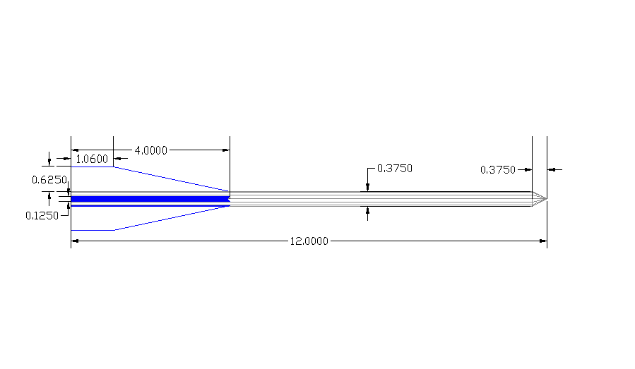

Where is the center of gravity (CG) from nose? CG is the balancing point.Jeeperforlife wrote:I have some 2" OD foam rod for a sabot. I am looking in to heat treating the tip. Any suggestions?jackssmirkingrevenge wrote:Looking good, with a suitable sabot it should be able to punch through a considerable thickness of steel plate
I took the dart to my work and got the weight for it. I is just over 1/2 pound (.61LBS) . I put everything in GGDT and this is what it gave me for the darts.
473FPS and 2083 FT. Lbs
If it is at 8.5 inches or less it will be stable.
I have a suspicion that your CG is greater than 10 inches which will result in very poor flight stability due to basically the fins being way too heavy. You either have to add nose weight or reduce fin weight.
For your efforts it looks great but it appears to have very poor flight stability characteristics! I hope you can prove me wrong.
You need the center of pressure (CP) to be about 1 caliber minimum behind the CG , in your case 3/8" is the caliber. I am guessing your CP is about 9 inches.

I just got home and the center of gravity of the darts is exactly 8" from the tip. I tied a string at the center of gravity and spun it around. It started backwards and in about 1 revolution it flipped around on it's own and flew great. I really did not expect them to do that well as I did not do any research first. I am lucky.dewey-1 wrote:Where is the center of gravity (CG) from nose? CG is the balancing point.Jeeperforlife wrote:I have some 2" OD foam rod for a sabot. I am looking in to heat treating the tip. Any suggestions?jackssmirkingrevenge wrote:Looking good, with a suitable sabot it should be able to punch through a considerable thickness of steel plate

jeeperforlife;
With your luck on getting that CG to CP dimensions proper on your first try, I salute you!
Better buy a lottery ticket soon with that kind of luck!
Looking forward to more pictures and video.
I can do a 2D/3D drawing for you and post it here.
Just need accurate fin dimenions.

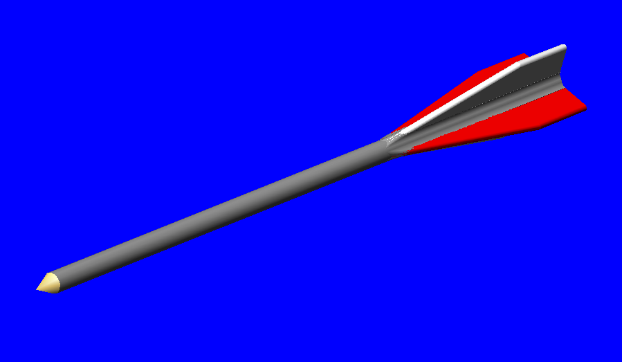

A drawing would be great.dewey-1 wrote:jeeperforlife;
Better buy a lottery ticket soon with that kind of luck!![]()
The shaft is 3/8" X 12" long
The fins are 4" long 1/8" thick, 5/8" tall. The back 1" of the fin is still a full 5/8"s
The angled part is 3 inchs long.
Thanks this is somthig I need to learn to do.
Marcus
Here are 2D and 3D drawings of your dart!
- 2D-Dimensional
- jeepers-dart-2D.png (4.48 KiB) Viewed 6498 times
- 3D-View
- jeepers-dart-3D.png (19.42 KiB) Viewed 6498 times
