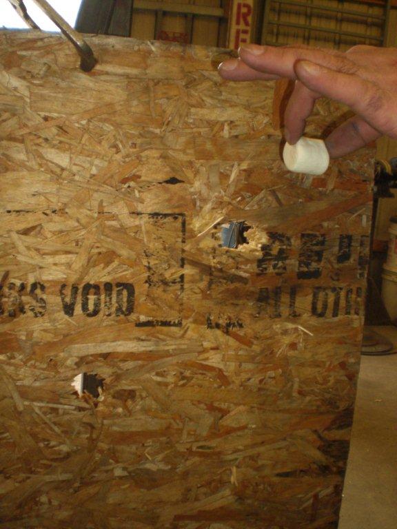

I was thinking about my grandkids’ marshmallow shooter, and started wondering "If you accelerate a marshmallow to a high enough velocity, would it be able to penetrate plywood?"
yep.

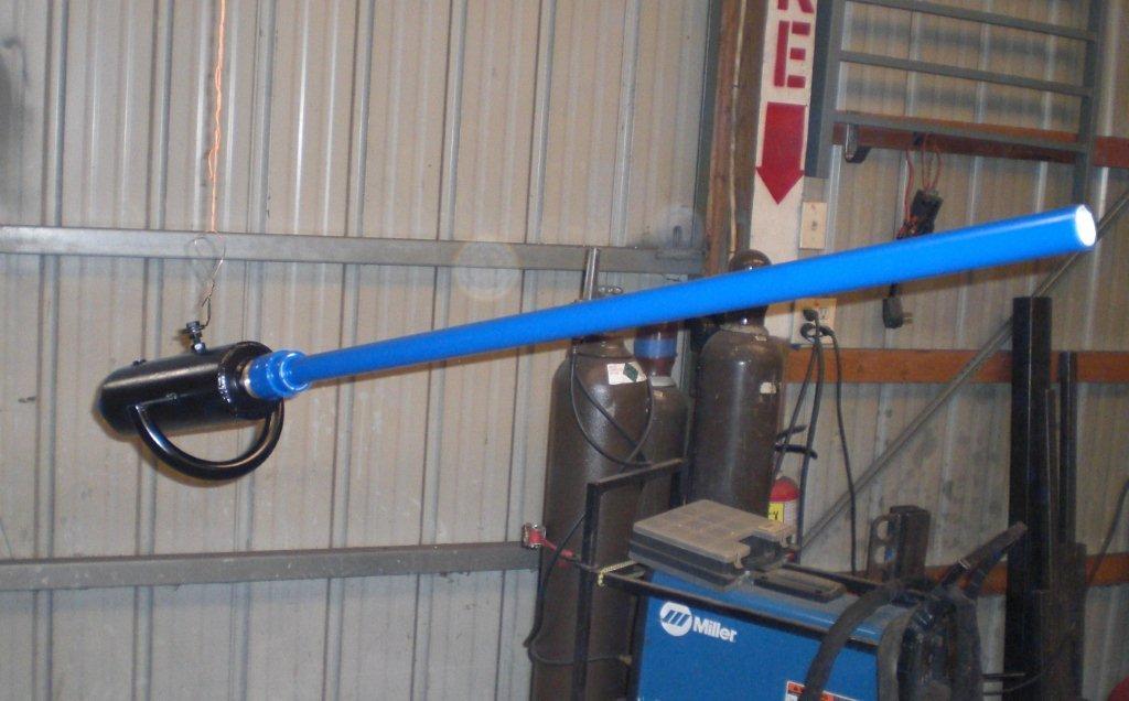

XP21 Thundersquish Tactical Marshmallow Cannon

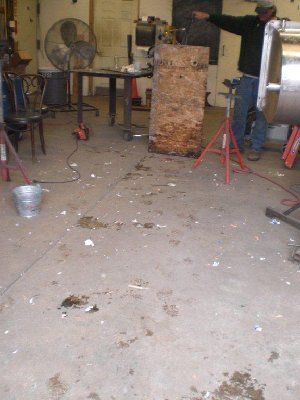

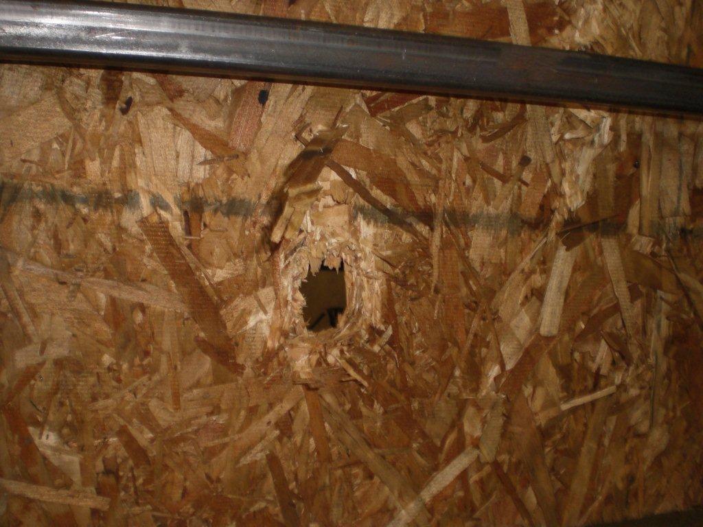

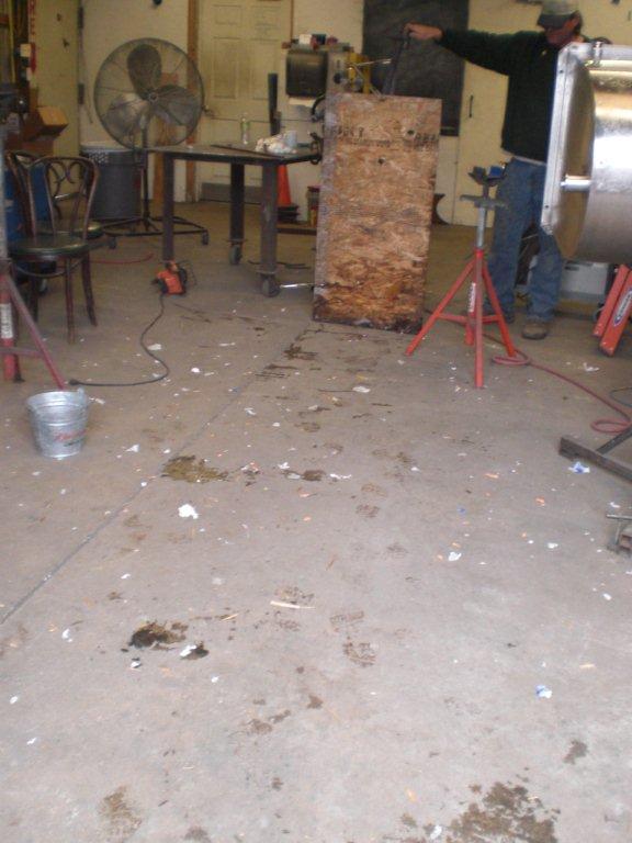

Neat, but I'd point out that OSB is not actually plywood - it's rather less impact resistant than true plywood.
Still, impressive performance nonetheless. Any idea what kind of velocity you're getting?

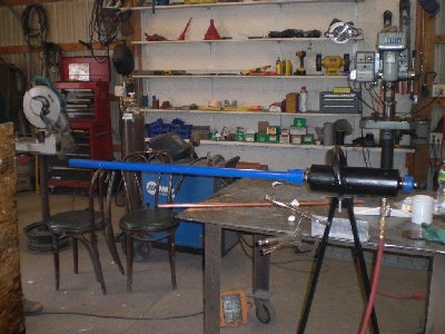

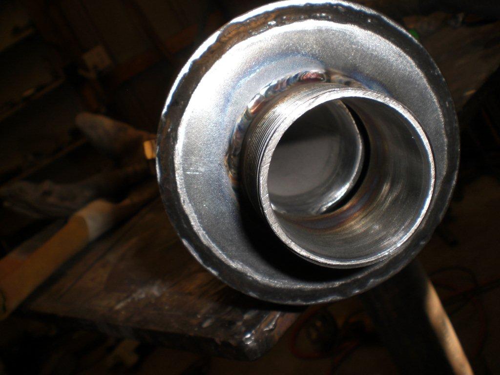

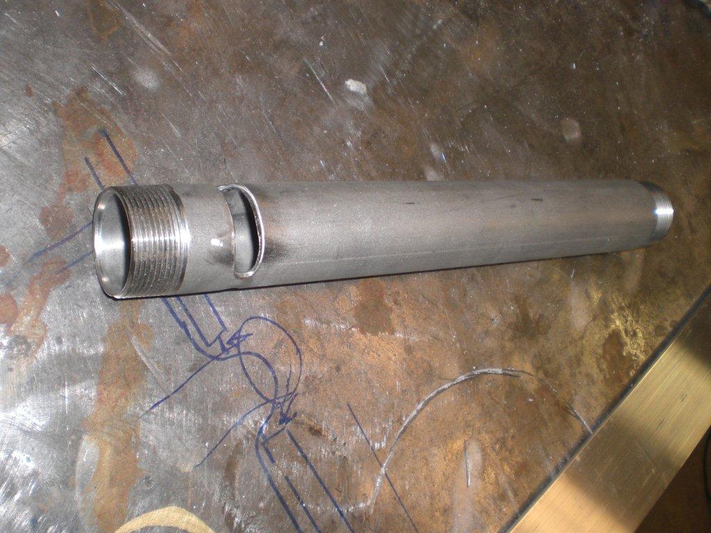

Twizi: That is indeed a pvc barrel, pressure rated at 465 PSI. These shots were made with 160 PSI air.
Ragnarok: Yes, I know that OSB is not technically plywood, but it was the only thing I had in the bone pile at the time. My goal is to punch through 3/4" true plywood. -More on that as events unfold.
According to GGDT, the muzzle velocity is around 850 FPS and the KE is approximately 175 ft-lbs.

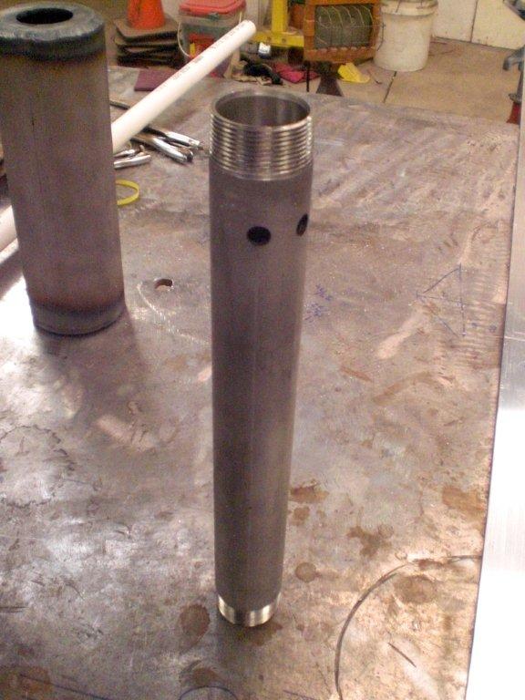

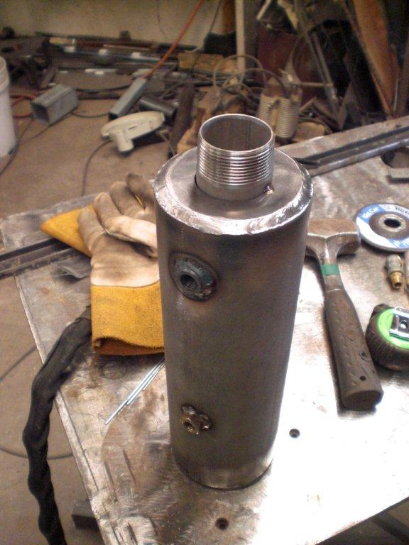

I did for the first one, but I have a machinist friend who turned this one for me.

Nice build, though is it really "tactical" before you slap on a few weaver rails and add a scope, laser and torch?

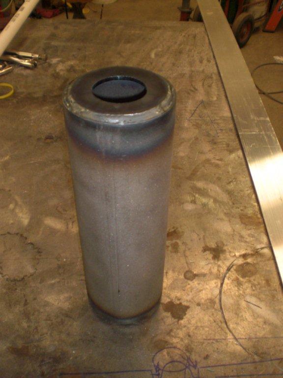

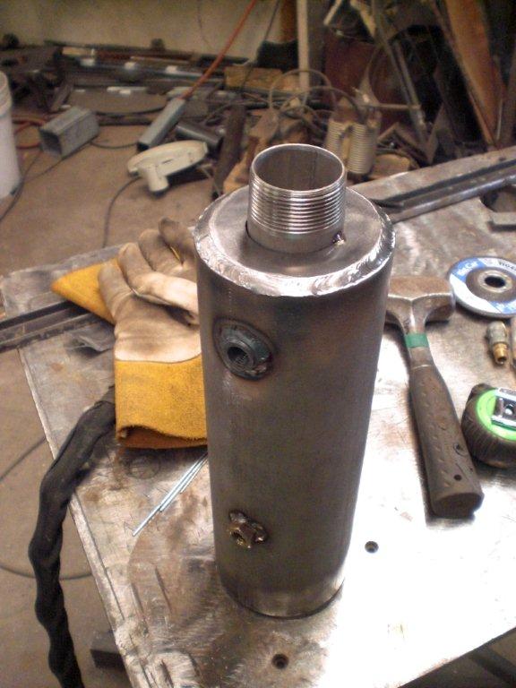

Extremely nice. I'd assume you've taken into account annealing weakening the material, but it all seems extremely well done. Looking forward to seeing more

Inonickname: You are correct. The steel being used is 50 KSI P&O steel, TIG welded and stress relieved per AWS qualified procedures.
Safety is always first & foremost in my shop.

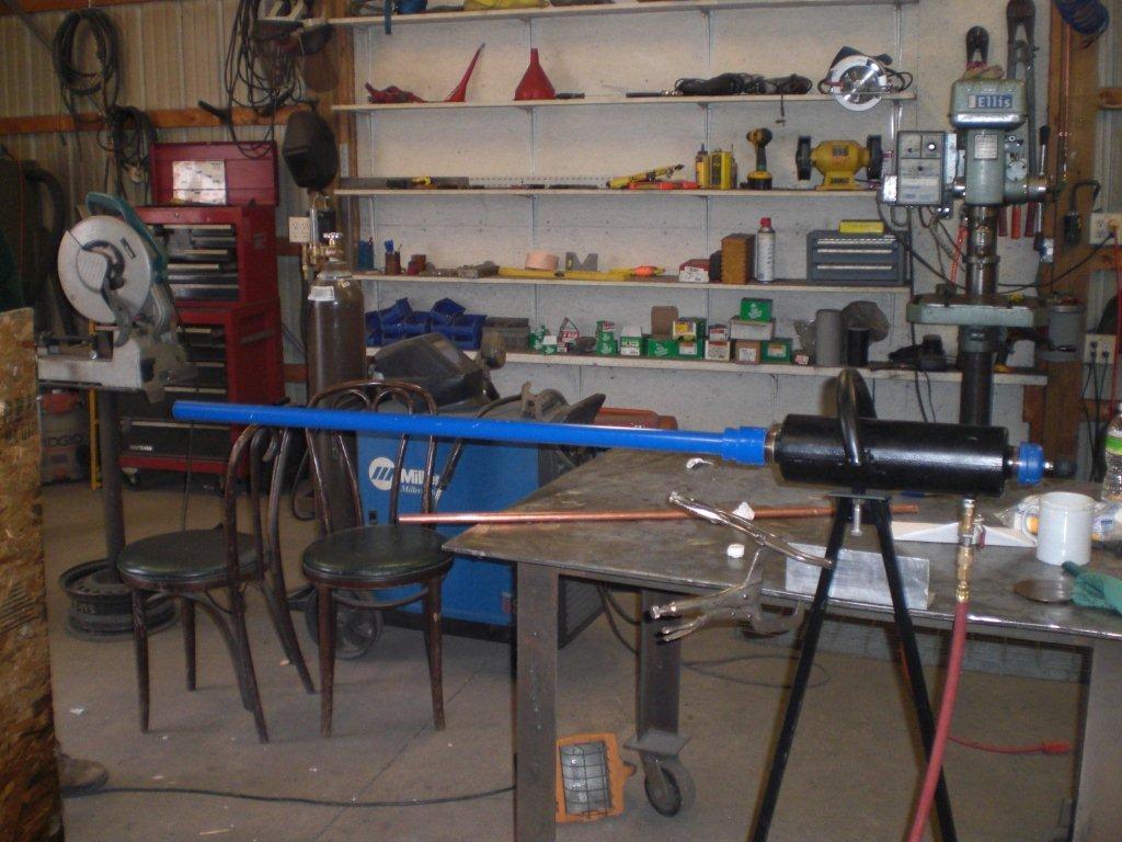

I've been thinking about a hybrid, but first I'm going to try going supersonic with 200 PSI helium... just to see if it can be done.
I'll try the used marshmallow idea. Might be interesting!
Also, I'm going to paint some marshmallows fluorescent orange (to make them easier to track) and see how far I can lob one.
I really want a crono & high speed camera now
Oh... and a lathe
And time. Lots of free time.
And a butload of money.
(**sigh**)
