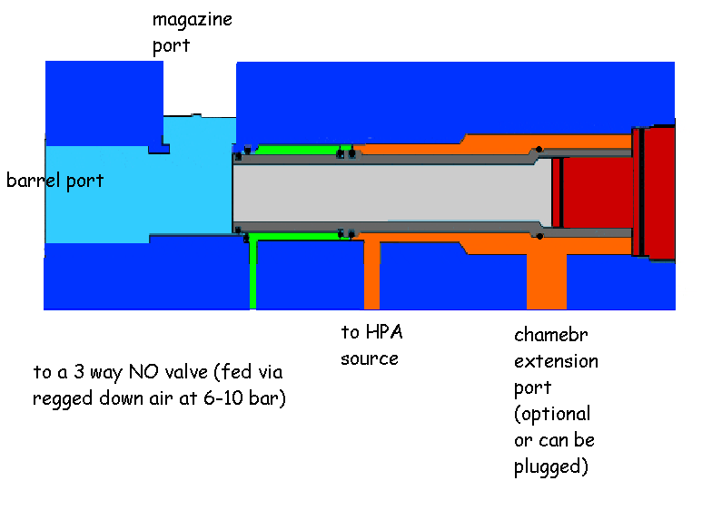

heh they are not mine.... credit goes to this guy
Ik now they are complicated.. I've been trying to desing something that would operate more less like them but would be simple to machine
Have a look here
can you see that block of aluminium there that joins all the parts and serves as housing for the loading mechanism?? I think it is possible to build a valve in a similar way
I modified one drawing... I think it could be simplified even more
I had to correct it
I had to correct it

that's just something I might build one day...
It will improve and simplify things a lot. Right now I need: a QEV, a T/loading mech and an air cylinder. This thing could combine all those parts into one rectangual block of aluminium and could be built to handle + 1000 psi pressures
