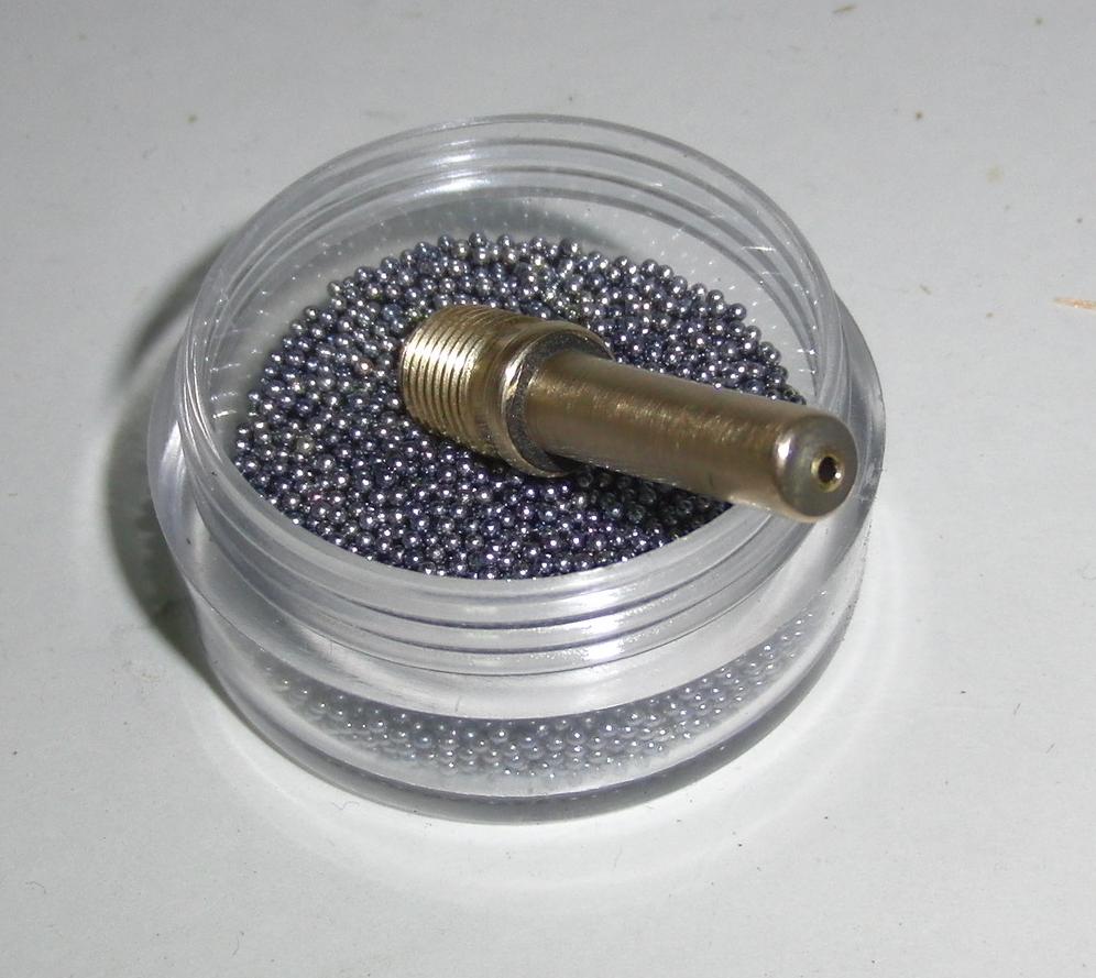

After this recent challenge I couldn't help but rise to the task of making the smallest possible (within reason) co-axial. Since the irreducable component is the schrader filling/pilot valve, I figured I might as well use the schrader body as the chamber.
Barrel is a 10mm long 1mm calibre length of brass tube, naturally power is laughable at best, a steel BB will ricochet off a sheet of paper - but it works :)
edit: did some more testing cranked up to 500 psi, a 1mm BB will happily punch through 2 sheets of paper. I tried using a length of 1mm rod as ammunition to make it more visible in high speed, the heavier weight and reduced velocity made it ricochet off the paper.
Here's a test video at 1000 frames per second:
edit: cleaned it up on my drill-in-vice "lathe" and updated the photos.
5000 1mm BBs for scale
The finished article posed with my grubby fingers

Technically at 800 psi there will be around twice the power, who knows it might actually penetrate a sheet of paper :roll:
Maybe you could add a stock or something to turn it into a true miniature piece of art.
The artist in me has long since died, function over form FTW! In that sense, it's not worth fiddling with something that will do more damage to the target if I drop it on it :)
