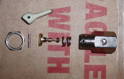

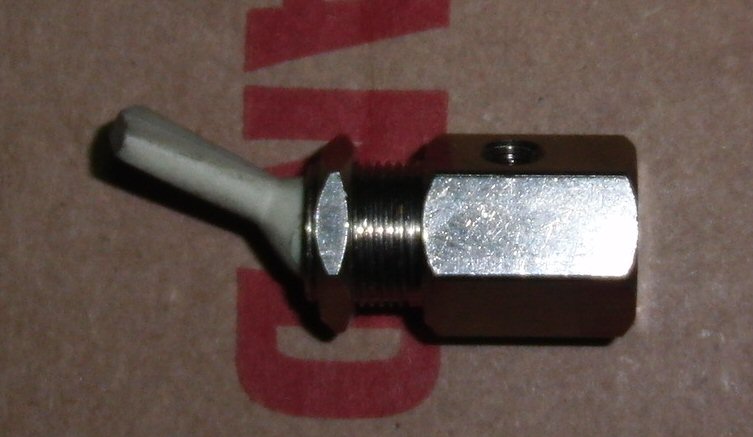

I ordered these, still want to make a decent semi
not sure how well they will take 400-800 psi but I sure as hell intend to find out

they are toggle valves so they stay in the last position... a spring return version would be a better choice for a trigger...
what size are they ? probably 5mm thread I guess, which means that their flow might be a bit low (good enough for piloting 1/8" and 1/4" QEVs)
now the question is whether they are spool or poppet valves? I am guessing they are spool valves which mean that they might handle it well
I guess you could have chosen better but we'll see... I like the way they look and how compact they are
it depends mostly on their construction... since they are direct acting there is a greater chance that they will...not sure how well they will take 400-800 psi

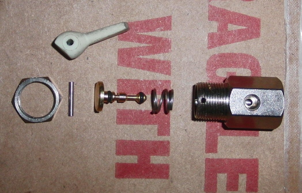

Making a spring return would be extremely easy so no worries there.POLAND_SPUD wrote:they are toggle valves so they stay in the last position... a spring return version would be a better choice for a trigger...
No idea but if I make a HPA semi it will be for 0.22"-0.25" calibre so good enough for my purposes, if I could pilot a 1" piston with a schrader these should be even better.what size are they ? probably 5mm thread I guess, which means that their flow might be a bit low (good enough for piloting 1/8" and 1/4" QEVs)
They're about 6 euros a piece including postage and I'll have four to play with so worth a try in any caseI guess you could have chosen better but we'll see... I like the way they look and how compact they are.
Package arrived today, basically a spool valve - the balanced construction means it should be quite happy with high pressures. Feed is through the port in the side, and depending on the toggle position, it either dumps through the back or leaks through the front bast the toggle itself, meaning some porting will have to be drilled to make it a decent pilot, but it looks like it's up to the job. Now for a prototype...

cool.. If you think of it it isn't much different from MRR's push-button valve...
well basically it looks the same (two o-rings)... the only thing he has to change is to rearrange the valve housing...
and voila a homemade DCV
