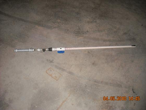

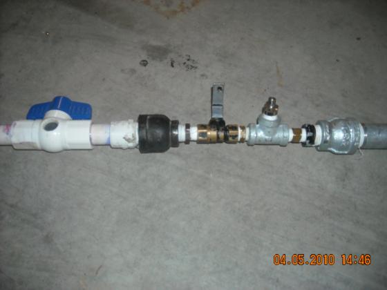

This is the air cannon that I built as a marshmallow gun. Origonaly it had a PVC chamber, but it broke so I replaced it with metal. Eventuallty I will replace the valve with a sprinkler valve. The ball valve on the barrel serves as a breach loader.
1/2 bore
200psi and under operating pressure

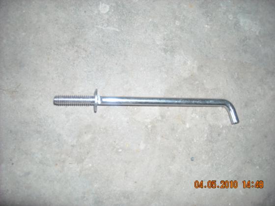

I make ammo by taking a hook cutting off the bent end sharpening the cut off end and casting lead on the threaded end. I use 1/2" copper as the mold for the lead.

Good job. Is this your first pneumatic? What is the target you were shooting at? It looks like a panal from a truck but I can't tell...

The PVC chamber consisted of an about 6" piece of 1.5" pvc and two endcaps. I drilled a hole in either end and tapped it to 1/4" npt, one end was screwed on to the valve and on the other end i screwed a pipe nipple and a ball valve with a quick disconect fitting. When the gun was pressurized (200psi) i accidentally dropped it and the pipe exploded from the valve being ripped out of the end. This is my second pnuematic, no pictures exist of the first.
The target is a fender fron a car. I have no idea what kind of car.
