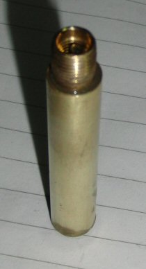

edit: fuçksocks, the seal didn't cure properly. 'couple more hours then
Here's a couple of views of the finished product, in that position the BB can hold around 30-40 psi, pushed further in it will hold at least 200

Wow the diameter is 1/4 inch? That's really small! And 200 psi is really sexy.
