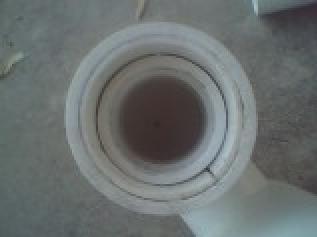

This shows how the vent valve will fit in the chamber.  It is not glued in yet, as I may change the look before it is finished.

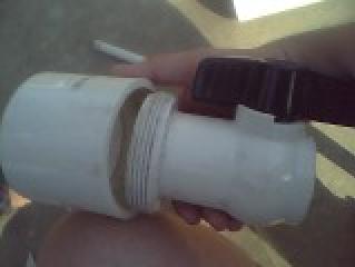

This shows the ball valve vent system.  It is designed so that it can be removed in case maintenance is needed.

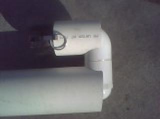

This picture shows the elbow portion of the launcher.  Notice how the fittings are countersunk in the breech end and chamber end.

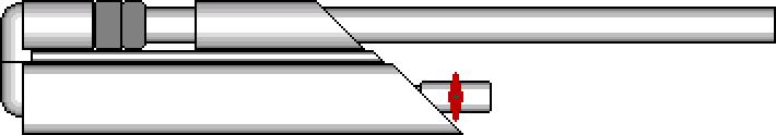

Can you post a diagram of the final product?

Are you using 3" fittings in 4" pipe for the chamber?
Slick. :)
What size is the camlock?

Gun Freak wrote:Can you post a diagram of the final product?
Yes I can. It is below.
mark.f wrote:Are you using 3" fittings in 4" pipe for the chamber?
Slick. :)
Why, yes. Yes I am. The power of Gort discovered this little tidbit a while back. And my sleeving calculator discovered that if you sleeve 3" thinwall pipe into 3" Sch40 pipe, it fits snugly around 2" fittings, which is what I've done to support the camlock in the image above.

That looks pretty nifty, I like the slanted style. Where's the sparker going?

I plan on actually having two spark strips in the chamber, one on each side of the interior wall. This will generate six sparks simultaneously, which will launch six flame fronts to travel from the outside . In theory, it should function the same as centrally placed three spark system without having any obstructions in the center of the chamber.
It may or may not work, but I plan on firing it with a stun gun and it will easily fire six sparks with the strips I have in mind (which are very similar to starman's spark strips).

Hubb wrote:...And my sleeving calculator discovered that if you sleeve 3" thinwall pipe into 3" Sch40 pipe, it fits snugly around 2" fittings...
Quite a useful tidbit there. Especially when making a piston valve in a 3" tee... hmm...

I love fitting shortcuts, did you do something special to attach the 3" threads on the ball valve?,

iknowmy3tables wrote:...did you do something special to attach the 3" threads on the ball valve?...
Everything I do is special :lol:
I cut a hole into the 3" cleanout so that a 1.5" pipe would fit through it. I glued the 1.5" ball valve to the pipe, then inserted the pipe into the cleanout. I trimmed the pipe enough so that I could fit a coupling over the pipe and it rest against the inside edge of the cleanout. I then trimmed the coupling so that it would be flush with the threads.
It sounds more complicated than it actually is, so I'll try to get some pics of it up to better explain.

This is a picture of the 3" support for the breech.  3" SDR was sleeved into the Sch40 to form a nice fit over 2" fittings.  The same is done for the barrel support.
