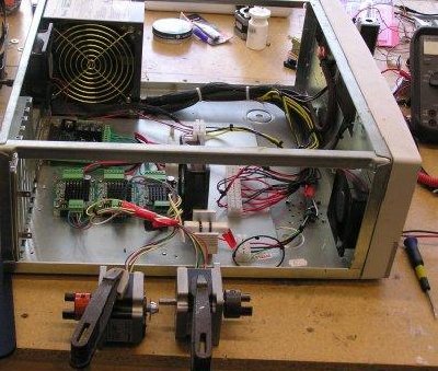

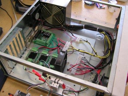

Motor control assembly, v1.0
The first image shows the overall assembly. The shell is an old PC case and the PSU gives me 12/5/3 VDC with plenty of current to drive motors, sensors, laser pointers or whatever.
In front of the PSU is a KTA-205 parellel port stepper controller than can handle four motors at once as well as two NC/NO relays, 4 input circuits for limit switches or whatever and 3x I/O ports for further expansion.
In front of that is the KTA-263 bipolar stepper driver that runs the motors. Clamped to the bench itself are the two motors for traverse and altitude.
Next step is to fabricate the turntable base and motor mount.
And plenty of fans! We like fans. Lots of them. Except boyntonstu. but yay, fans!
This is growing beyond my basic grasp of electronics, I would never have considered the sentry gun project without the ready made software/controller package.
Fans, yeah. Those stepper controllers get HOT, especialy when you have motors pulling 2.5A and sitting still in the "locked" position holding something in place.
