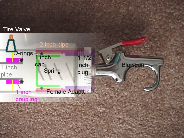

- modifications_to_blowgun_402.png (21.75 KiB) Viewed 7545 times
- normal_blowgun_diagram_123.png (35.38 KiB) Viewed 7545 times

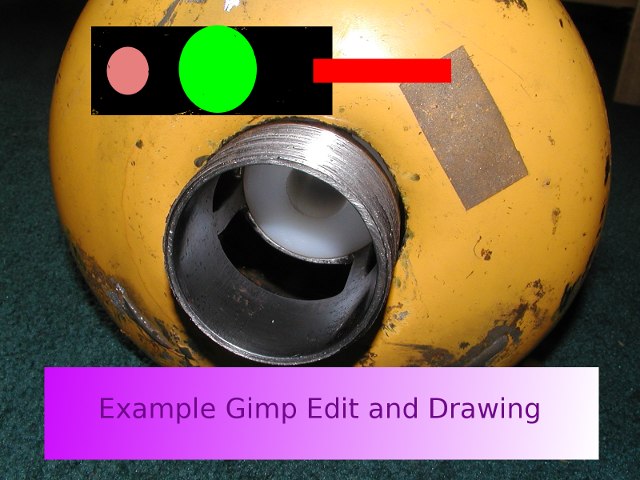

- Technician1002
- Posts: 5189
Install The Gimp. I use it for edits and drawings as well as photographs. Sample edited photo is below.sorry about the bad drawings. I am running a version of Ubuntu on my computer
Edit, I found another photo I did long time ago. I composited some photos together with a drawing to show the internals of my Mouse Musket.

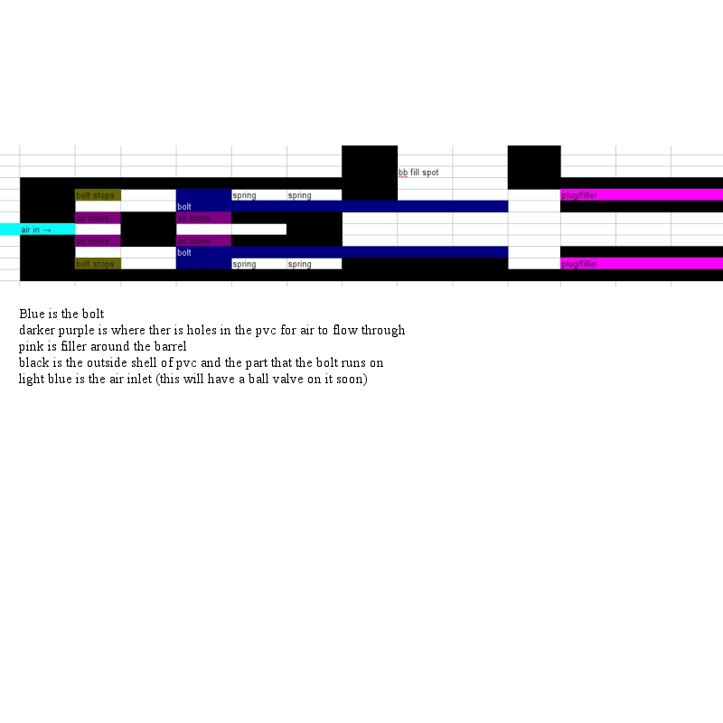

ok, here is a rough diagram that I drew up.
Blue is the bolt
darker purple is where ther is holes in the pvc for air to flow through
pink is filler around the barrel
black is the outside shell of pvc and the part that the bolt runs on
light blue is the air inlet (this will have a ball valve on it soon)
When the ball valve is opened, air slides the bolt forward and cuts off the loading tube at the top. As the bolt reaches the end of its movement, it allows air to flow through the front holes and into the barrel. this pushes out the bbs. When the air flow is stopped, the spring around the bolt pushed it back to it's starting position, allowing bb's to drop into the chamber.
I already have something in the barrel to keep bbs from falling out the front if I tilt it down. I'm planning on starting work on it this weekend, so I should have pics up as soon as I can get a camera. My main question is, does this look like it would work? and has it already been done in a way that is easier to build? Thanks for the help, I'll probably have more questions as I run into problems I can't handle or can't find a way around.
Sorry about taking so long to put up usable pics and constructive criticism is welcomed.
