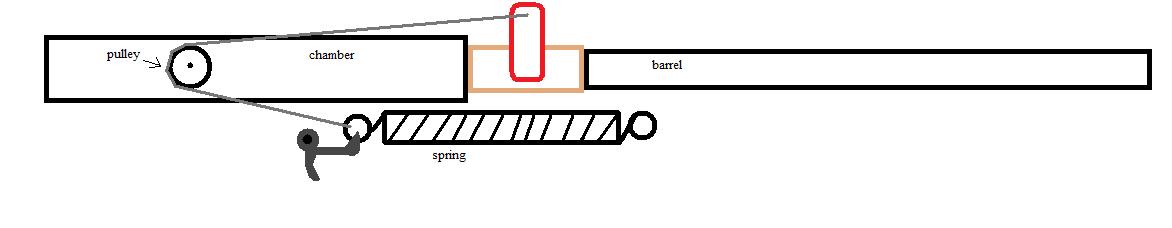

The main problem with most spring-loaded ball valves (besides the fact that they are ball valves) is the way you have to set them up. I haven't yet seen one with the trigger behind the ball valve. Always in front. Because of which i designed a spring loaded BV with a pulley and i was wondering if you guys think it would have the same performance?

Well the pulley would create more friction, but it should work just about the same.

Just make sure your pulley is well lubricated and aligned well. I look forward to seeing this built.

the trigger is still a little more in front of the valve. i want the trigger to be significantly more behind the valve.

This design should allow you to place the trigger anywhere you wish.Marffy wrote:the trigger is still a little more in front of the valve. i want the trigger to be significantly more behind the valve.

I made one exactly like that but everything is turned around compared to your sketch. I think theres really not much difference witch way you turn it...
At first it worked very badly because I had a weak spring for this system. When you use a pulley like that you loose a lot of spring energy so I had to step up to a more powerful spring. So if you want to keep performance similar to an inline spring-valve handle design you need to go with a spring with at least double the power.
I could of placed the trigger as far back as I wanted but I tried to make a 1:1 replica and didnt really care how far the trigger will be compared to the valve handle

Actually I don't understand the renaissance of ball valve cannons at the moment
. A well made piston cannon is and will be superior to BV cannons big time, especially when you are going multi shot.
However, I do have some experience with ball valves and here are my 2ct.
1. Shorten the lever on the ball valve and use a strong spring to fasten opening time.
2. Put the spring inside a piece of pipe to protect you fingers.
3. Release the screw of the ball valve a little bit and/or lubricate the inside.

1. Shorten the lever on the ball valve and use a strong spring to fasten opening time. Agree. Use a bigger valve to open wider/degree.MRR wrote:Actually I don't understand the renaissance of ball valve cannons at the moment. A well made piston cannon is and will be superior to BV cannons big time, especially when you are going multi shot.
Not needed if spring is forward of your fingers.
Also, addition friction will weaken the spring's force.
Do NOT release the handle.
File own a space between the handle and the valve where they meet until there is light between them.
Lubricate, yes.
Best way is to:
remove handle, replace nut.
Chuck a socket that fits the BV nut into a drill (15 mm for my 3/4" valve)
Spin it at the drill press lowest speed/hi torque setting until it feels pretty warm. Cool down, repeat several times.
(insert a wood dowel to hold the ball to loosen the nut.)
Use a fish scale to measure the initial force, mine was about 10 pounds.
It got down to 2 pounds.
Another tip: Close the ball valve to ~80 degrees where it still seals.
Spring does not have to pull that initial 10 degrees.
Pull from the 80* position.
I recommend a $15 ebay 50 pound pistol crossbow as the spring and or the trigger mechanism.
You can also use multiple rubbers each one easy to cock but adding force to the group.
And last, pull on an arc for a constant torque.
If you just pull the handle its like a bicycle pedal your force weakens as your foot pushes down beyond horizontal.
FWIW
2. To put the spring into a pipe makes perfect sense when you use something that can rip the flesh off your bones, no matter in which position the trigger is. The additional friction (if there is any at all) can be neglected.
I've used this spring on a ball valve cannon and to cock it is a challenge of its own.
3. To loosen the screw is absolutely ok with me. If you feel uncomfortable with that then use a drop of Locktight.

Believe it or not, this is a bad idea. Here is the argument.Another tip: Close the ball valve to ~80 degrees where it still seals.
2 cars are drag racing. One starts 20 feet behind the starting line and is permitted a rolling start. Neither car can cross the line early. Both cross the start line at the same time. One is traveling 40mph as it crosses. Which car will make the first 40 feet the quickest?
A running start before the valve cracks open is a good thing as the actual time taken to open is shortened once it actually cracks open.
All my valves are using a pre open travel distance for a running start when they do open.
