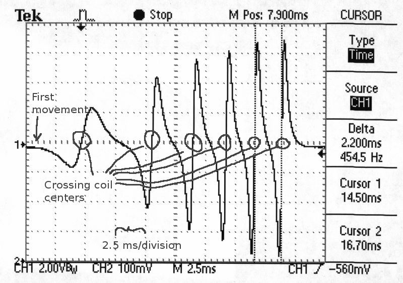

It performs much like a burst disk. Without the broken edges of a burst disk, or the extra length for union or camlock for a burst disk, it seems to have a slightly higher COF. When launching a 4 inch foam ball and clocking the acceleration, I tried to match real performance with GGDT. I had to up the COF to get a match in acceleration and muzzle velocity.
Below is the launch data for the 2 oz 4 inch foam ball. This scope trace was generated by the ball with a small magnet passing through pick up coils on the barrel spaced 1 foot apart. Feel free to take this data and match a curve in GGDT.
Final foam ball speed was in excess of 450 FPS. Not bad for a 2 inch valve feeding a 4 inch barrel.
