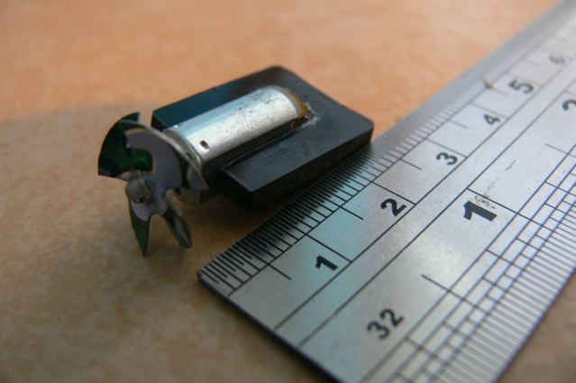

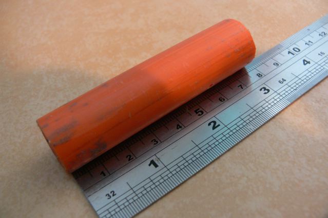

this is a mini i made in a couple of hours its kinda ghetto but i was just wondering is a chamber fan would make a mini of this size any better/easier to use it may not be that powerful but i think the fan works quite well on this mini.
Edit: here are some pics of the improved version, i think its much better
barrel: 6mmx140mm
chamber: 15mmx80mm
fuel: propane butane mix
ignition: pizero
gun length: 250mm
ammo: BBs

i got the motor from an old cd player, i made the blades from some very thin aluminum and just cut the mount out of some plastic then glued them all together

Nice thinking, but I was wondering how you actually mounted it onto the combustion chamber.

theBOOM wrote:Nice thinking, but I was wondering how you actually mounted it onto the combustion chamber.
oh ok sorry, if you look at the picture of the fan you can see the black U shaped peace of plastic which fits tightly in the camber but so it can still slide, then i put some glue on the inside of the U then slid it in the chamber then you put the fan in and center it, solder some wires on made a small hole in the chamber put the wires through then slid the fan in. hope that answers your question.
