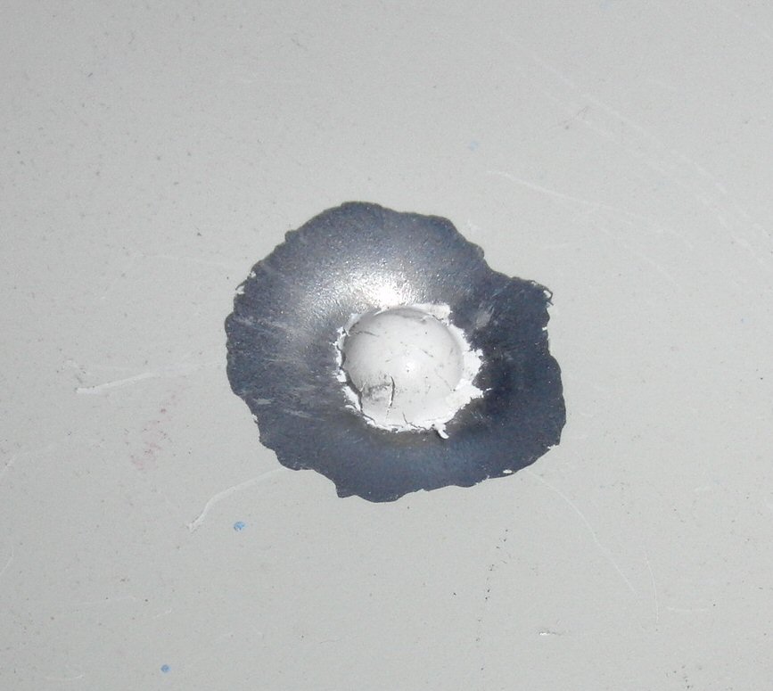

I'm made a similar launcher to the one in the original thread, only beefed up for HPA and with a rubber seal to enable airsoft BBs to be fired.
It doesn't seal perfectly, clearly an asymmetric locking of the projectile is not ideal - still managed to make some BB pancakes though :D no penetration but that's 1mm steel and I'm "only" using 450 psi:
No idea how fast they were going though, BOTH my friggin' chronys' batteries have run down!
BB pancake :D
BB pancake :D
yes, I know it's bent, just a proof of concept :P
