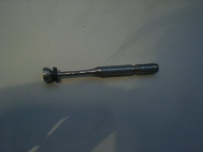

A while ago I made a simple single shot pellet gun which worked well and had a XRV hammer valve. I decided to try an upgrade it to a multishot hamer valve much like sniper heros. Most of its pretty simple and is just threaded fittings. Right now my only problem is the actual bolt with oring grooves that is ground down for better flow. I pulled out a spare bolt and popped it in my hand drill since I dont have a drill press. I held the file against it and was only able to cut shallow grooves into it and couldnt grind down the "stem". Is there a better way to do this with a hand drill?
Sniper Heros
Sniper Heros
sniper hero.jpg (7.72 KiB) Viewed 3031 times
That is all.
The uneveness makes me think he did it by hand/blood/sweet and tears. A piece of sand paper will work wonders while turning the work piece in your drill, just use a back and forth motion and even pressure with a steady hand/s. Lock your drill in a vise and use the trigger on lock, then you can hold your sand paper on both ends like a belt.

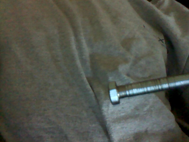

I wish I had a lathe but for now I dont I guess my best bet is Jrrdws sandpaper idea. Heres the only progress I made in 10 minutes with a file.

I dont know how quick you expected it to be but that doesnt seem much slower than I expected, how fast does your hand drill go? If its not to quick I think its more time efficient to sand by hand.
