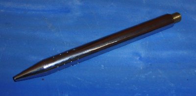

Eh today my first coaxial mini is curing :D it's in the oven right now, speeding up the process.
EDIT: Jack, do I need to add a bumper onto small coaxials like this???
Right now I have 3 pistons in mind, one that is made out of plastic, very light but might crack after long periods of use, casting one out of hot glue, or casting one out of epoxy. I just want something that will last me a while.
Insomniac wrote:I tried it a moment ago... it maintains structural integrity all the way up to 160psi, and I got about three or four successful pilots from it.. but now the piston ain't sealing right. I used a solid bit of rubber from an eraser, which I think is too soft.
Possibly. Also note how I usually add reinforcement to the breech end of the barrel in order to better support the piston and reduce wear, an important consideration when it is impossible to replace it.
Oh well... I'll stick the arse end of it in hot water to soften the glue and try again!
That's one benefit over epoxy I suppose ;)

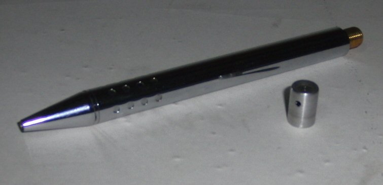

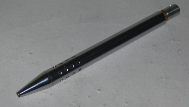

Here's the latest in the series which I made as a prize for the Fall 2010 best shot contest, still have to make a cap as a firing mechanism, will make some videos then.

thats fantastivly cool :D :D
Make a decent video and it could be yours ;)
Here it is in action at 350 psi:

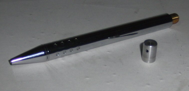

Update on the contest pengun, added a cap for firing :)
ilovefire
Posts: 511
looks good, really should make another one of these there quite fun to make :)
