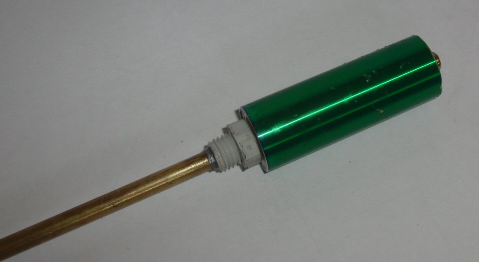

What I had in mind in terms of action was basically identical in principle to what I was doing with my combustion cartridges.

Cheers guys, though it will be a "huge" success when I can have it fire and cycle a semi-auto action ;P

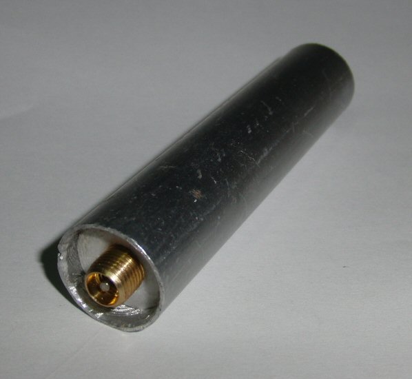

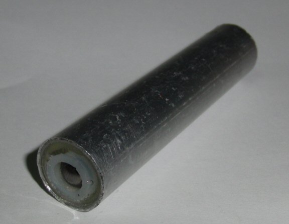

Here's a couple of pics of the "magnum" version for a 3/8" bearing, I'll test it some time this evening when it's fully cured. The one thing I'm not sure of is the seal pop-off pressure. Note how the schrader is recessed in the cartridge body in order to afford some measure of protection if it hits the ground tail first.
If I pressurise the cartridge until it pops, it holds the BB until about 150 psi very consistently. The important thing is to always push the BB to the same depth into the seal.Did they seem to be pretty consistent as to releasing the BB-- not too much variance in the silicone?

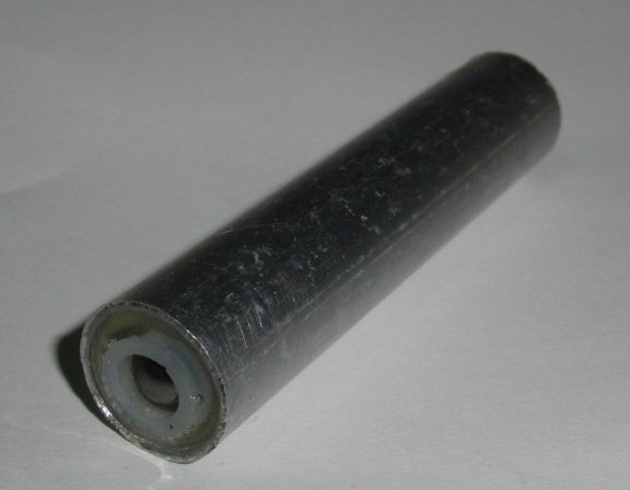

Well, I tried it out, the seal will retain pressure without popping out up to 45 psi, so I'm limited to a 4x mix - which worked (BLAM! even without a barrel the BB left a 3mm deep dent in my wooden wardrobe
I'm going to reglue it with araldite and see if I can increase the pop-off value.
