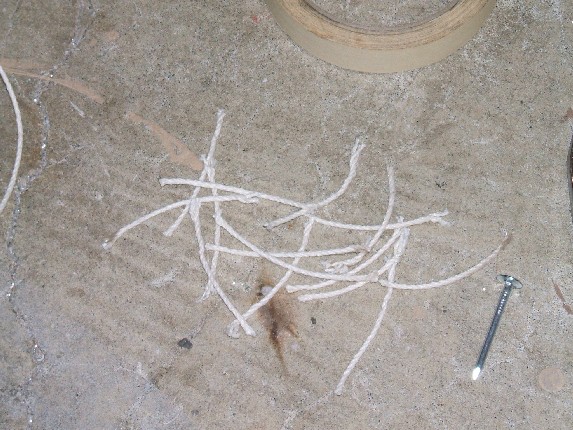

These are easy to make darts that take five minutes, no tools, and regular household materials.
Materials:
Nails (1 1/2" to 2" is optimal)
1/8" string or yarn
1/2" wide tape
These are easy to shoot with a 1/2" Sch 40 blowgun or just barrels on cannons. They are a perfect fit, are stable, have great penetration, and take about a minute each to make.
Don't shoot people.
All the materials
All the materials
Cut about 15 pieces of string 2" long and a 5 inch long piece of tape

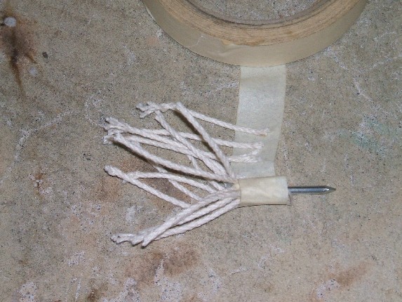

Line up the string on the tape, along with the nail
Roll it slowly, keeping the tape flush with the nail's head
The finished dart
The finished dart

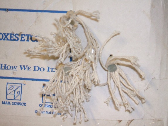

All of these darts were shot, not stuck into the box
A few darts
A few darts
