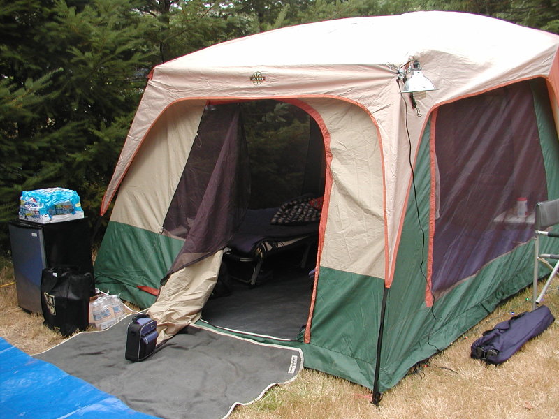

My inverter. Note the small black power cord off to the left. It is ~24 inches long to the battery.
EDIT
Added photo of roughing it with the inverter. Electric lights, refrigerator, ran all weekend off a 25 foot extension to the Prius. The 42 watt CF is much brighter than a 2 mantel Coleman. The weekend took about 2 gallons of gas. We had ice cream in the freezer. :D
Roughing it with no hook ups.
