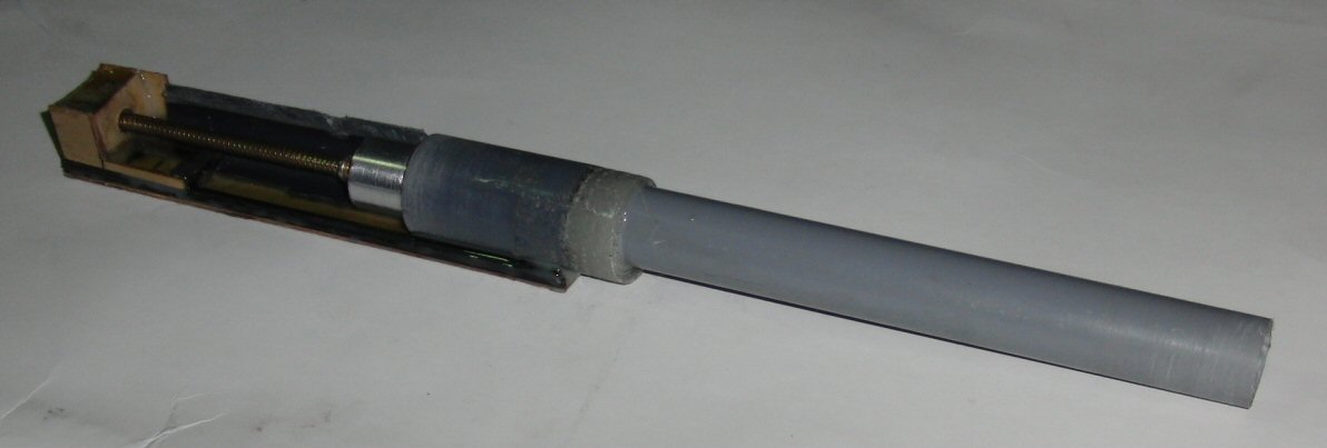

Here's the breech and bolt setup curing with cartridge in place, to be tested later today :)
lozz08
Posts: 239
Joined: Wed Jul 01, 2009 7:33 am
I can't wait to see it in action. It looks great. Have you given much thought to how the cartridges will eject? (Side ejection/magazine feeding) Is the sheer force enough without anything guiding the motion?
lozz08 wrote:Have you given much thought to how the cartridges will eject? (Side ejection/magazine feeding)
The plan is to have it feeding from a fairly conventional vertical bottom mounted magazine, and ejecting sideways to the left. As pitured it's lying on its right side.
There's an edge visible half way between the end of the cartridge and the bolt block, the base of the cartridge strikes this on firing and it causes the cartridge to tip out sideways, something like this:
The problem with the above is that the bolt starts to return the instant the cartridge stops, in order to avoid this I plan to add more weight to the bolt in order to give it more momentum and continue moving back even after the cartridge has been tipped out.
use a check valve - air would be allowed to exhaust from the cavity behind the bolt but on the return stroke it would be slowed down by vacuum
the added benefit is that you've the bolt housed inside a length of pipe so it reduces the chance of injury
if the bolt is housed inside the pipe you might even use a floating oring as teh check valve
