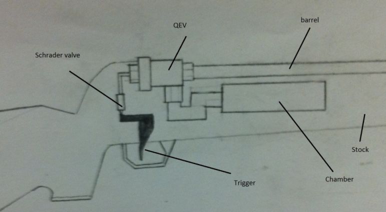

If you post a diagram of what you intend to build it would be easier to give you specific advice.

jackssmirkingrevenge wrote:If you post a diagram of what you intend to build it would be easier to give you specific advice.
This is a bit late, but I hadn't actually put anything on paper until you said that. I threw up a rough sketch of what I plan to do here. I won't embed the image, as it's quite large. Perhaps you could critique me on it (the launcher I mean, not how to resize my photos :P).
A potential concern I see is that the schrader will severely reduce performance as opposed to a blowgun (if it's effective enough to actuate the QEV at all).

r00kie wrote:I won't embed the image, as it's quite large. Perhaps you could critique me on it (the launcher I mean, not how to resize my photos :P).
Resized and posted ;)
I don't know about QEVs but for a 1" piston valve a schrader pilot was good enough for my purposes. You could also consider a 1/8" or 1/4" ball valve as a pilot.

jackssmirkingrevenge wrote:I don't know about QEVs but for a 1" piston valve a schrader pilot was good enough for my purposes. You could also consider a 1/8" or 1/4" ball valve as a pilot.
You have a very small pilot area in that example, I think that would greatly contribute to it's effectiveness. When the QEV finally gets here, I'll test it out and let you know how effective they are with schraders.
I have tried to steer clear of ball valves, they are quite effective, but in this case I want aesthetics. If the schrader reduces performance noticeably over a blowgun valve, I might switch to one, but I'm really trying to keep it looking as good as I can. :p

r00kie wrote:You have a very small pilot area in that example, I think that would greatly contribute to it's effectiveness. When the QEV finally gets here, I'll test it out and let you know how effective they are with schraders.
Technically the cup seal on a QEV should act as a one way valve ensuring it should actuate, but I can't tell you how much it will affect performance. What i can tell you is that on my schrader actuated pistons, pressing the schrader stem sharply gives noticeably better performance.

jackssmirkingrevenge wrote:Technically the cup seal on a QEV should act as a one way valve ensuring it should actuate, but I can't tell you how much it will affect performance. What i can tell you is that on my schrader actuated pistons, pressing the schrader stem sharply gives noticeably better performance.
I suppose I could make some kind of hammer that depresses the schrader when the trigger is pulled, but that seems to make it unnecessarily complicated as opposed to a blowgun. It would also mean it would have to be cocked after each shot.
Using the solenoid out of a sprinkler valve to depress it is another idea that comes to mind, it would require power, but nevertheless it sparks some interest.
