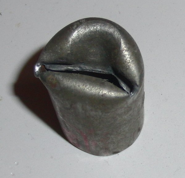

As far as damage to the projectile, this is damage after punching holes in stuff. The damage is from remaining KE after going through the crate.

Yeah, that's "wasted" KE, either from impact with the targets or the backstop. But my point remains, it doesn't actually take that much energy to deform a 12g like that, so it may be deceptive.Technician1002 wrote:As far as damage to the projectile, this is damage after punching holes in stuff.
That's unfair, I could have made the barrel 6 feet long and the chamber 10 times bigger but I have neighbours to think aboutRagnarok wrote:Hmm... this doesn't actually seem to be indicative of all that much energy. I've shot air rifles at empty CO2 cartridges before, and they usually look like that after just a shot or two.

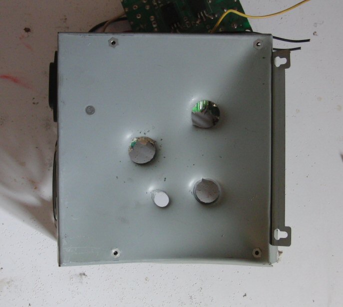

Speaking of which, I had a morning of chrony testing planned but bloody typical, my last ignitor gives out! I did manage one chrony shot though, at 10x with a 30 gram capsule, 278 feet per second - that works out at 79 ft/lbs (slightly better than your air rifles eh Rag

Edit: unbelievable, all the shops I went to only had the flint type lighters :-/ in the meantime, gave it a go as a burst disk pneumatic fitted with 3 layers of photo paper disk (one layer bursts at around 160 psi) and hooked up to an 800 psi supply, it was surprisingly quieter than the hybrid and less powerful than a 10x shot, piercing the power supply case but not nearly as much as the hybrid.
