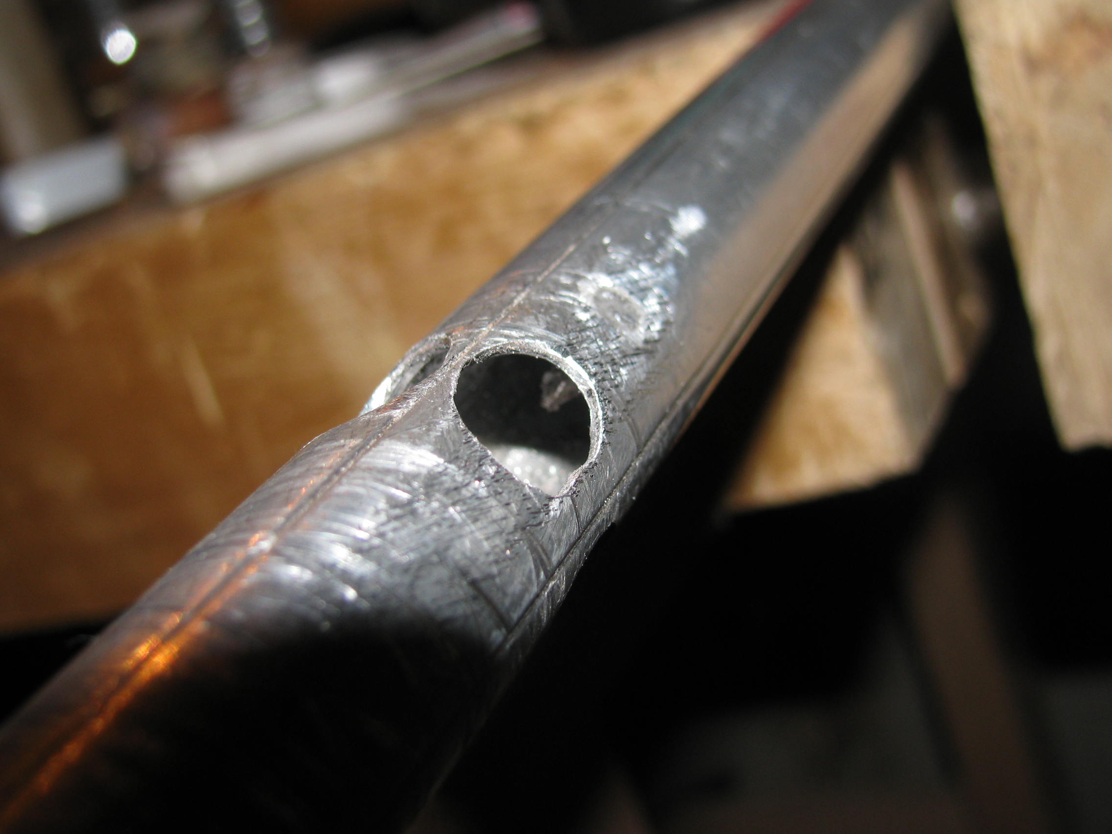

That's exactly what I tried last week, only thing I used strong fishing line instead of cable and a O-ringed, short and light piston out of alu pipe epoxied together. I planned on just attaching the fishing line to a simple trigger, but the problem was, that it was kind of hard to pull under pressure (like it seems in your/airgunmans videos boyntonstu), without pressure it was really easy to move the piston. I think this was because the O-rings deformed under pressure...POLAND_SPUD wrote: use a steel wire/cable (essentially just bicycle cable brakes) to open the valve...
...put a spring behind the piston that so that it can reset it
But the big fail of the gun, (I'm still disappointed) was the fact that I build a restriction out of a short piece of a nail, which I glued trough the pipe in front of the piston, the prevent it from going too far, when it is reseted.
Finally the restriction nail broke off, and now I have a small hole in front of the ports, what makes the gun useless.
