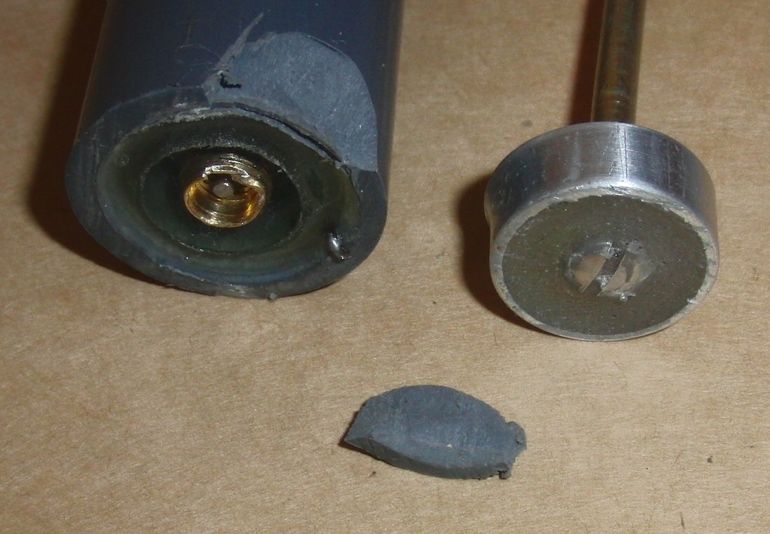

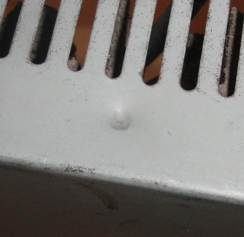

Here's the latest test:
Pretty nice clip even if I say so myself, because you can clearly see the ignition spark jumping from the bolt, as well as the flash shining through the cast epoxy breech.
You can also see the chip of cartridge fly off where I underestimated the strength of the blowback and didn't put a rubber buffer on the ejector, and also the bolt face itself has been deformed by the impact.
Power wasn't too impressive either, just a dent in steel sheet, however a stronger bolt spring would likely significantly increase that.
When are you going to be able to try out feeding ?
I reckon the stroke might need to be longer with the ejector slightly further back, to give more time for the next cartridge to move in.
Although there does seem to be a slight delay on the bolt return, maybe from the off centre force twisting the bolt as the cartridge was ejected.
I'm going to have to make a new cartridge and bolt, and reconstruct the bolt housing.al-xg wrote:When are you going to be able to try out feeding?
I've lengthened the stroke, but there really is a lot of energy in the shot to eject the cartridge, meaning that the return spring can be very strong, meaning I can afford a strong magazine spring that will quickly load the next cartridge without too much friction preventing the cartridge from moving.I reckon the stroke might need to be longer with the ejector slightly further back, to give more time for the next cartridge to move in.

Anyway, back to the subject of this thread, I made a new cartridge and bolt which are currently curing, I shortened the cartridge length to 3 inches (increasing stroke), now that there's a sturdy copper structure I can experiment with different ejector locations. To avoid damage to the cartridge as in my previous test I'll bolt on a rubber block as the ejector.
