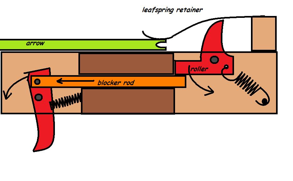

I made a crossbow too, it had a winch on the back and a steel wire 4mm thick as the string, unfortunately a trigger capable of easy fire and 800lbs+ of force couldn't be found :lol:

There you go:
Very smooth on the string, it just folds out of the way.
You can play with dimensions ( long trigger, small roller) to up the capacity.
Make it in steel and it can hold whatever force you'll get out of any crossbow.
I have used this principle on numerous occasions in some form or another.
Even the trigger system on Old Shatterhand works like this.The roller being a hammer..
The roller doesn't have to be round , but it is the most simplified version.
I used it on a mechanical marblegun, wich I had to cock with all my strength during the time I was a competative bodybuilder.. still very smooth triggerpull.
edit:
Although I had flipped it around to be bullpup..( included diagram)
This idea enabled a quick draw, locking in the string in a single pull.
A leaf spring holds the arrow in place.
Important note with this design, all moving parts MUST me smooth and could use some teflon spray from time to time.
