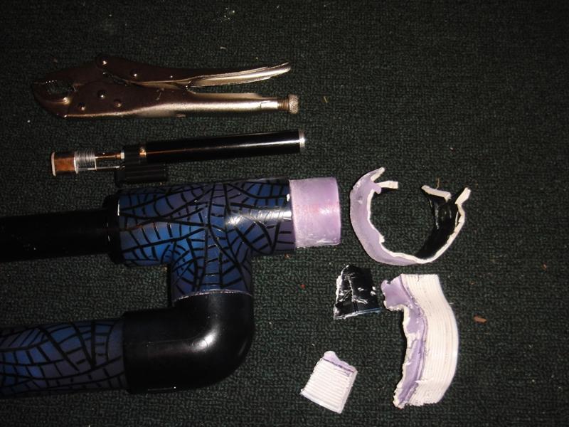

Recently, I made a little 1" porting pvc plinker since I was bored. After some tweaking I was ready to assemble it for good. Since I was using pvc and I wanted the piston serviceable, I used a re-inforced cleanout cap(nsf-pw plugs apparently don't exist here).
After applying a goodly coating of PTFE, I proceeded to crank 'er down nice and tight.
*crack*
(insert FUUUUUUUUUUUUUUU guy)
Well, that didn't work. The female adaptor split, taking a bit of the piston housing with it (did not affect the tee).
I did not want to start over, so I decided to see how well pvc glue really does bond fittings...
After about 20 minutes of slowly heating with a pencil torch and peeling it away with vice grips, I removed the cracked fitting with no damage to the valve. At this point I am certain of my solvent welding ability and that the cans of primer and cement were fresh. PVC glue simply does not join as well as the prophecy foretold.

Valve and remains of the 1.5" female adaptor.

I've heard of people boring out fittings with a hole saw/lathe/etc (Mr.Plow did it for his Banjo Cannon barrel IIRC), and I've actually seen a tutorial on here for removing fittings using heat and a screwdriver. :roll: Glad to see it worked for you.
