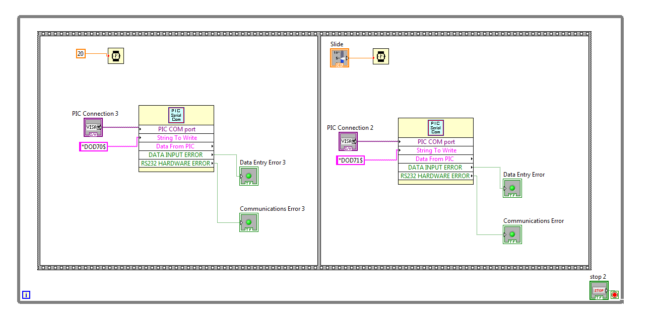

- The block called "PIC Serial Com" is the sub VI provided by my professors. Essentially you send strings of data to the "string to write" port.
In my VI, I have a sequential case structure that is executed from left to right. The structure is enclosed in a while loop so it runs indefinitely. In the first frame is the 20ms period during which the servo receives a LOW pulse. In the second frame, the servo receives a HIGH pulse for a duration of 0.6 to 2.4ms which is determined by a slider on the front panel. Changing this value *should* change the position of the servos.
Of course, it does not work as desired. - servo.png (36.86 KiB) Viewed 3799 times

There is the strong possibility that the UART for the serial port can't support a pulse string. You may wish to try pulsing a uP data port instead.
The servo may respond like that with a low data rate pulse string. The bits sent by a serial port with the start, data, parity, and stop bits may cause the servo to jitter toward one end of travel until it reaches a stop.

I am wondering if you have the time of the loops correct. A long servo pulse tends to move it clockwise. The direction of your servo indicates the pulse may be long and the rep rate may by 2,000mS instead of 20 mS.
The 20 ms rep rate can vary quite a bit without much affect on the servo. The pulse duration is the servo position information. Some RC transmitters with only 2 channels may have a shorter time for faster response in cars and such. Transmitters with more than 8 channels may reduce the data rate so there is a minimum reset after the transmission of the last servo pulse.
12 channels sent serially from a transmitter at max 1.5 ms each is 18ms for the string. 2ms may be too short to sync the receiver. The idle time after the last pulse has a minimum requirement by the receiver to remain in sync. The long dead time is used to reset the channel counter in the receiver.
Again I recommend using a speaker for testing. If you get a metronome tick, tick, tick, at a 2 second rate, that may be all that is wrong.
Don't forget to check if your port is active low instead of active high. A voltmeter can be used to check this. Correct is less than 1 volt DC. Incorrect is above 4 volts.
Your posted time waveform for driving a servo is correct. A 1mS pulse should drive it near center.
I'm still wondering if you are trying to send this to a UART? The attached graphic indicates a RS232 connection. You can't drive a servo off a RS232 data line with the exception of the DTR pin, which can be manipulated in some hardware.

Thanks for the replies. I've more or less come to the conclusion that the subVI my professors have provided holds things up too much. That, and I don't know if USB2.0 can even support the data transfer. I can post the diagram of the subVI if anyone thinks they may be able to make sense of it (I certainly can't).
If my professor approves, I'll make a 555 timer circuit or program a separate microcontroller to drive the servo upon receiving a signal from the PIC Board... That shouldn't break any rules.

Thanks for the tip. That sounds more logical than the schematics I've seen which use just one. Also, my professors confirmed that sending servo pulses the way I planned won't be possible here. They also approved of my actuator so I will certainly be using that in the project. A small payload must be released from a robot car. This actuator will provide the easiest way to do so.
