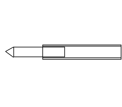

Yeah that's what I was thinking about... though who said you can't build one yourself ?
anyway you might as well use drag stabilised ammo... get, let say a
10cm X diam. 20mm steel rod and sleeve it into 30cm lenght of PVC pipe

- POLAND_SPUD
- Posts: 5402
Hmm I think that something along these lines should be enough... sure it isn't optimal as far as cd value is concerned, but as long as it stays stable in flight and has high mass then it should be ok
- lol I is an artist ;-)
- mcrowley_lol.png (2.67 KiB) Viewed 17791 times
