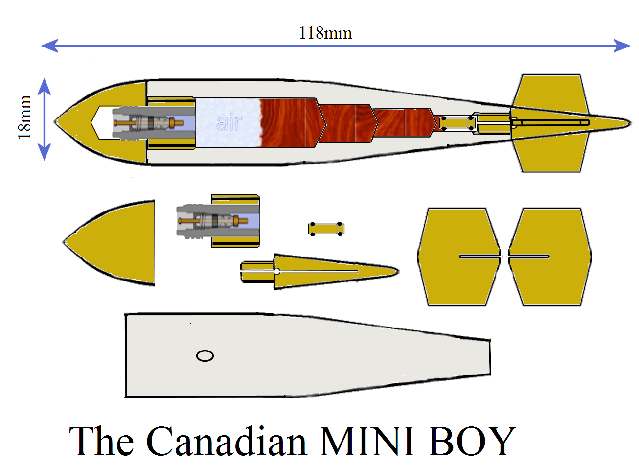

Okay, here's some more food for thoughts.
You have a plunger (this little rod with 2 o-rings) that I expect to be kept in place by pressure, then dislodged at impact.
The internal cavity contain some bright liquid dye that can go through the holes in the tail if the plunger is moved.
To fill it, You unscrew the nose, drop the plunger inside (push it in place), fill with dye, then close and add some compressed air. I expect the plunger to stay right where it is, just by pressure alone.
At launch, centrifugal force will keep the plunger in place.
A impact, the plunger will sink close to the nose, opening the tail slits for a powerful dye spray. because the opening is just below the fins, I expect a widespread spray range.
What do you think?
This could be used as a valve that you can unscrew to fill the cavity. The cap would be replaced by the brass heavy nose

Interesting thoughts... How about using the impact itself to spread the dye through a piston as per the attached diagram, which forces the dye out by popping the rubber bungs. Maybe the bungs should be moved more towards the tail in case the nose is buried in the sand.

I didn't though about using the plunger as a piston... hmmm....
it simplify a lot things for sure :D
But I still think the spray must be through the tail an upward to have a chance to be visible, not on the sides as the missile will certainly be fully buried. I'll try to incorporate that in the design.

I think the dye option is a bit of a dead end, though it seems to work for 40mm practice rounds without pyrotechnic enhancement (though it is fired at ranges less than half a kilometre):
I also think we're exagerating the vulnerability of electronic circuits. I posted this link for an acoustic beacon in the first post.
Very cheap and surely if they could make 60 years ago electronic proximity fuzes that are essentially small radar transmitters/receivers that can survive being shot at several thousand feet per second, we can make a simple buzzer circuit that can be shot from a hybrid without disintegrating.
Those tracker designs look interesting, and coating the circuit board in epoxy and placing it in a padded housing as I suggested before should ensure it survives both the shock of firing as well as impact with the ground.
