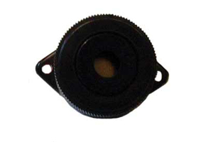

That looks a bit too bulky. I suppose something like thiswould do just as well. I would incorporate a circuit that pulses the noise, in order to preserve battery like as well as creating a distinctive tone that would be easier to locate than a constant buzzing.
Small pizeo units can be quite loud. The come in back up beeper configurations. Just add a battery.
Operates on 3-28 Vdc. Continuous tone. 103 db sound pressure. 1.14" diameter x 0.93" ABS plastic housing. Can be bulkhead mounted with tabs on 1.31" mounting centers, or can be mounted through a panel hole of 0.7" diameter via threaded bushing and panel nut. 5" wire leads. Black housing
It is LOUD.

Regarding piezos, they wouldn't work considering the 1kpsi behind them which would flatten the piezo-electric crystal.
Same as for any speaker, the diaphram would be burst. Unless you put it facing forwards which would affect range.
Really a lose lose situation. A small radio transmitter would be the best way to you I think.

I bought 2 thingies today on the local stores that I found loud enough. Both have a very high pitch tone. And both are a bit too big to fit the inside of the 18mm missile that was planned :(
1st is a personal alarm thingy that sound when you unplug a strap. Works with 4 small lithium battery. 115db, fast pulsing sound, rectangular 24x13x80mm.
2nd is a Pulsing Piezo Buzzer. wired to a small 12V alkaline battery, it's maybe a bit louder than 115db, fast pulsing too. diameter 29mm, length 24mm. one battery dia. 12mm, length 30mm. Bulkier, and I have to fix the battery somehow.
I tried a few smaller piezo (they had a good selection at the store), but the sound was really not that impressive. Inside the missile body, I think they would barely be audible even with holes in it.
The piezo diameter seem to be a bit smaller than the plastic container diameter but not that much. That would fit in a missile body diameter of 1 1/4" (32mm). It's the larger aluminium tubing I have at hand. And with a thickness wall of 1/16" (1.6mm) I'm afraid it would not survive the impact and crush. Anybody have an opinion/experience?
The personal alarm thingy may fit a smaller tube, maybe 25mm, but those 2 round recess you can see on the photo are not for the battery, they seem to be resonance chambers. I wonder if the internals would work outside their plastic container.
No big deal to try to destroy them, it was only a few $, but I wonder if someone would have some idea to share before I cut them open?
