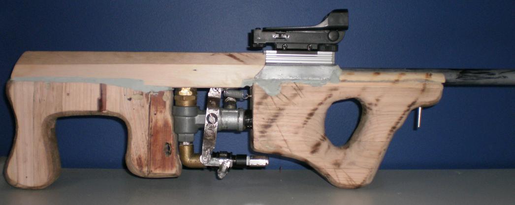

iv been building this on and off for about 2months, its not finished just yet but fully functional. only needs to be sanded and painted
SPECS
Barrel: 650mm of 20mm electrical conduit, its really loose 1mm each side :( need a upgrade.
ammo capacity: one 20 round mag and two 10 round clips. all spring fed, homemade springs.
Valve:1/2'' festo qev, 10mm seat.
Pilot Valve: 1/8'' pantball slide valve.
Chamber: 10cm of 3/4'' galvanized pipe. small but 600psi makes up for it :twisted:.
Operating pressure: 200-600 psi, with my 1l tank i get 20 really good shots 10good shots, then i refill it.
Reload mech: homemade air cylinder to cycle ammo, the receiver is two brass tees with a peace of 20mm copper pipe soldered in it.
thanks to Poland_spud and jsr.

you can see the groove cut in the wood for the trigger to ride in.
that is the hole thing. needs some finishing touchs. I have two aluminum plates that cover the valve and trigger rod.

So air ram connected to chamber loads ammo from behind the QEV ?
Does the trigger close the fill valve and pilot in one action ?

Alster370 wrote:The stock seems quite chunky, but very nicely done anyway. I think a caliber of that size at the pressure you intend to operate could do some serious damage. :D Post a video?
the stock is only 45mm thick, i cbfed sanding it more round and its stronger this way. ill get a damage pics soon and if i can find something to protect my video camera ill have videos

al-xg wrote:So air ram connected to chamber loads ammo from behind the QEV ?
Looks good !
yea that how it works, the trigger pilots in when you pull back and fills when you let go, i have a safety that stops it coming back if you engage it.

This is really cool. About how heavy is the whole thing? Also, what are you using for an air chamber? How is the feeding of paint balls? Everything is so neat and has similar specs I would like to accomplish on my build. Great work !!! :D

Hmmmm im not sure id say about 2.5-3kg + 1kg for the fire extinguisher tank, Its a marble cannon i don't use paint balls, it would most probably mush paint balls if i did use them.

What's performance like? I've found marbles that fit very well in 20mm conduit (17mm) so maybe some searching is in order to reduce blowby and optimise velocity.
A diagram of the feed mechanism would also be of interest if you have the time ;)
defiantly need a new barrel, im looking. i might be getting 500 15mm ss bbs for free, if so i have a steel barrel id is 15.07mm i would just need to get 1/2'' bsp threads on one end, but i can do that at work.
but the power is pretty good for the barrel, easily puts marbles though 9mm mdf boards.
i made a safety that when you push it in the trigger cant be pushed back, and the trigger is really stiff so i don't think it needs a real guard

Cool, nice gun. so does it run just from the pressure in the galvanized pipe, it isn't attached to a separate tank or air compressor?, cos if so i might nick that idea.
Gun Freak
Lieutenant 5
Lieutenant 5
Posts: 4971
Yes it needs a tank or a compressor to run.
