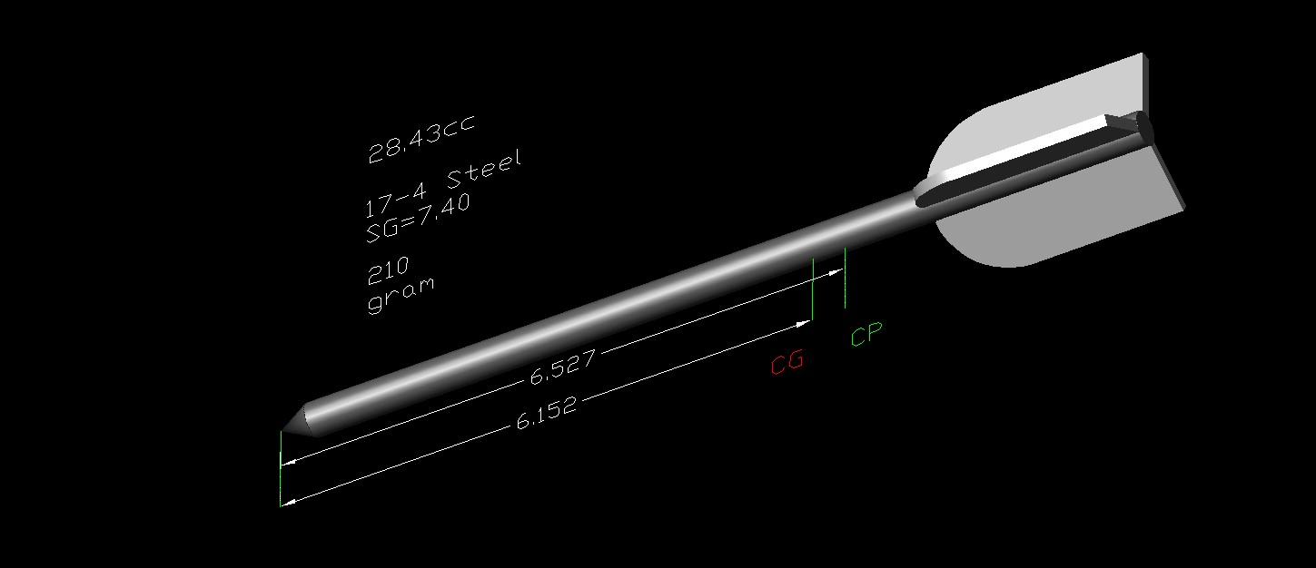

After a little bit of penetration testing, I have decided to fire my custom made round for distance. The problem I am having is that I do not know how to calculate the drag coefficient. I thought you guys might be able to help. The rod is 3/8" in diameter by 10" long with 3, 2.5" by .75" fins welded on to it. I realize the probability of recovery is very low but a drag estimate would be useful. If you need any more information, let me know.Image
A bit difficult to calculate, is usually determined experimentally.
Looks like it will go far though, what are you shooting it out of? And what does the sabot look like?
You could make your own wind tunnel, this is from 1942 - when men were men and carved their own propellors!
Isn't irisher's projectile too tail heavy?
MrCrowley wrote:Isn't irisher's projectile too tail heavy?
... but the fins are pretty huge so the centre of pressure is very far back.
irisher
Posts: 420
Joined: Mon Dec 29, 2008 2:53 am
I actually thought it would never work after I measured center of gravity but I have had great success with this round. The sabot system is short dowel wrapped in duct tape as the pusher plate and carved Styrofoam as the guides. I am firing this thing out of my 1.5" sprinkler gun.
irisher wrote:I have had great success with this round.
Videos/photos please!
dewey-1
Posts: 1298
Location: NE Wisconsin USA
Here is the CP based on 1/8" thick fins.
The CG should be at least one caliber 3/8" ahead of CP.
irisher, where is the actual CG?
irisher
Posts: 420
The center of gravity is exactly 6" from the tip. I made some holes in 1/8" plate steel but the fins never actually get through. It will bury itself approximately 5.5" into solid wood and is quite annoying to get out.
