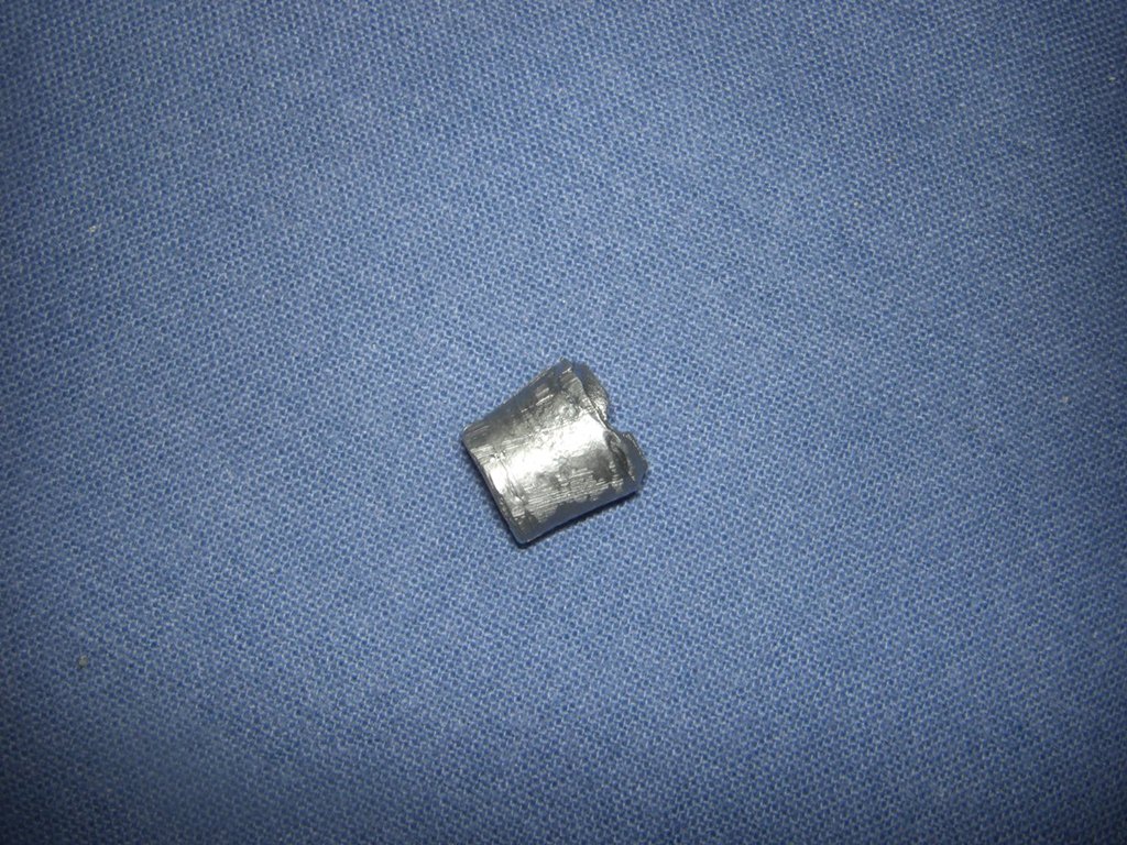

demage to 7.62 "specialbullet" after firing at a steelcan

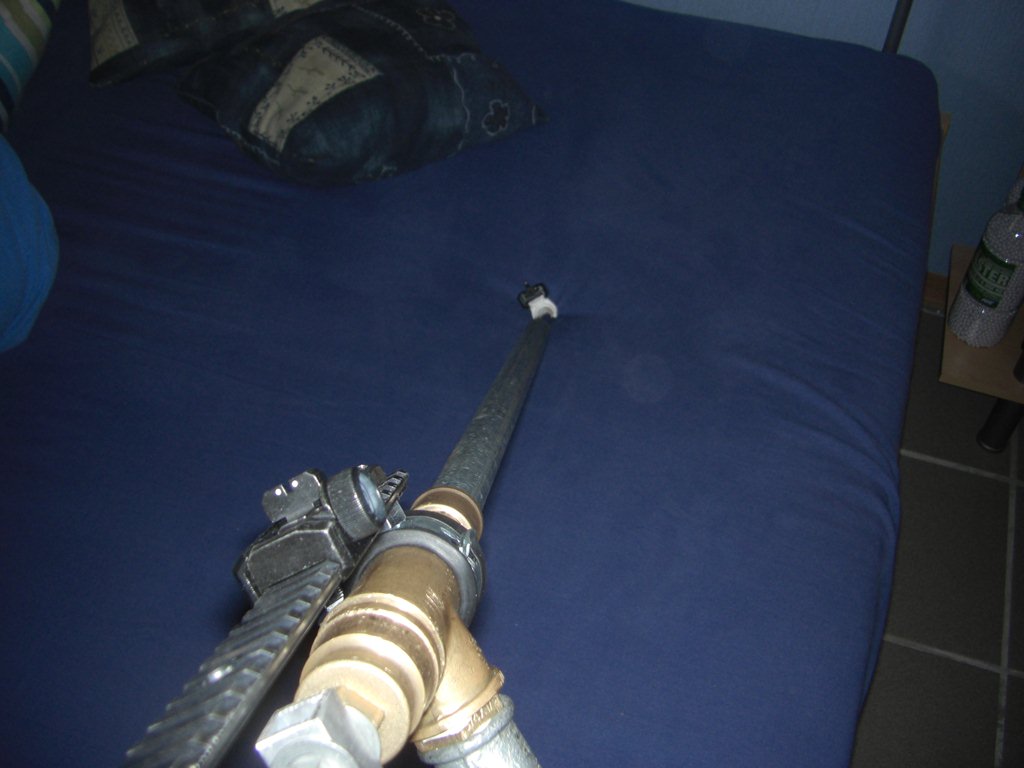

Airchamber and Pistonhousing...
The whole Gun
The whole Gun
Nicely done. How are you sealing the trigger assembly in the valve? A o-ring?
Welcome to Spudfiles. :D
Very nice, you will be happy with the power difference when you take it up to higher pressure, though it will be loud! Some pictures of the piston assembly would be welcome, as I imagine it is made of standard parts and of interest to anyone who might want to replicate the design :)
How did you rifle the barrel and is it effective? Copper isn't too hard a material, even compared to lead.

my friends and me have build the airgun new with new barrel, silencer and piston.... :-)
Gun complete
http://www.abload.de/image.php?img=dsc_0717agtm.jpg
Piston with spring
http://www.abload.de/image.php?img=dsc_07189ijh.jpg
