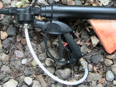

air chamber-2 feet of 2 inch pvc
valve- 3/4inch sprinkler valve (first attempt at modding one!)
trigger-old pressure washer handle with a functional safety

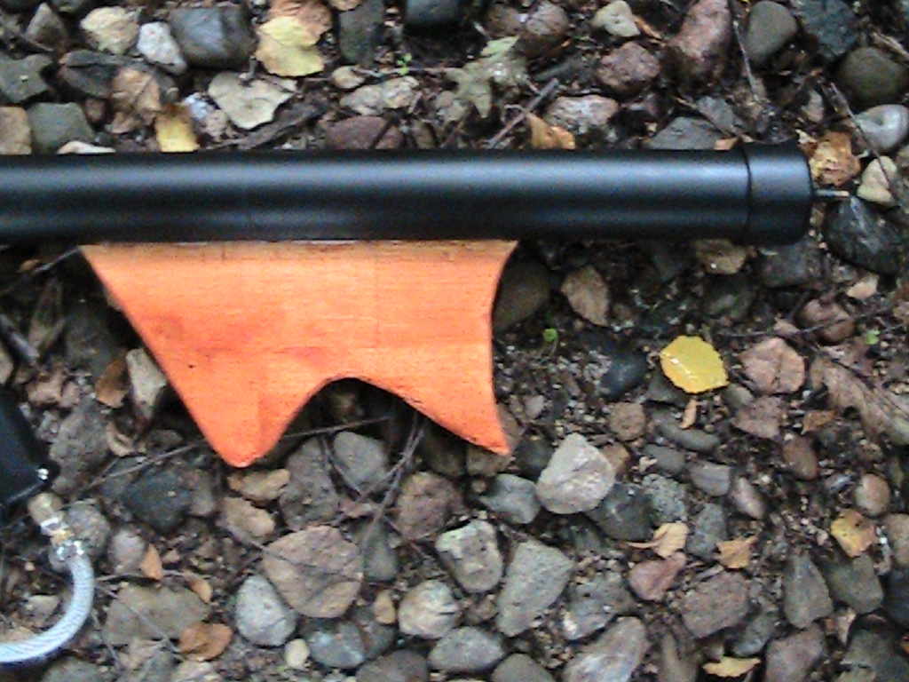

stock
stock

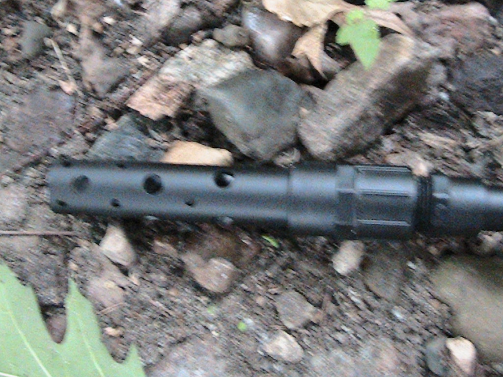

muzzle brake
muzzle brake

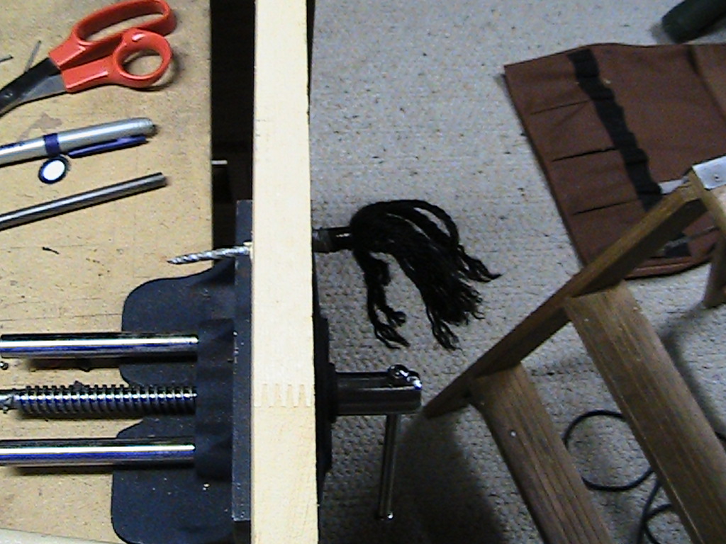

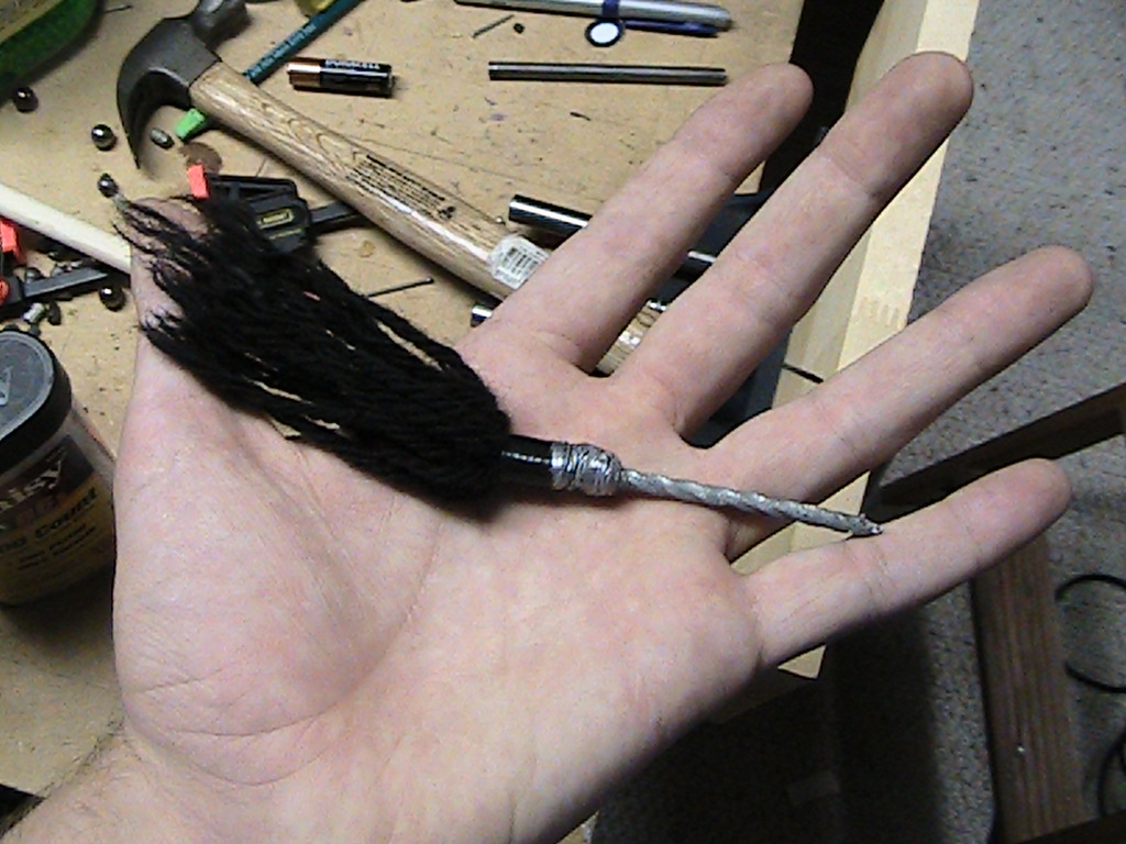

dart
dart

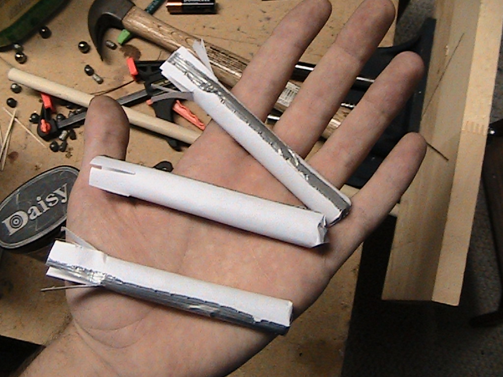

shells
shells

The pressure hashed handle seems kind of overkill ( :o ) any plans to replace it and use it for a higher pressure project?
I love lamp
urgle the danish cow
Posts: 176
Joined: Sun Jul 26, 2009 4:48 pm
Lockednloaded wrote:The pressure hashed handle seems kind of overkill ( :o ) any plans to replace it and use it for a higher pressure project?
if the need arises then i will but atm i enjoy having an easy to use and comfortable trigger with a functional saftey
