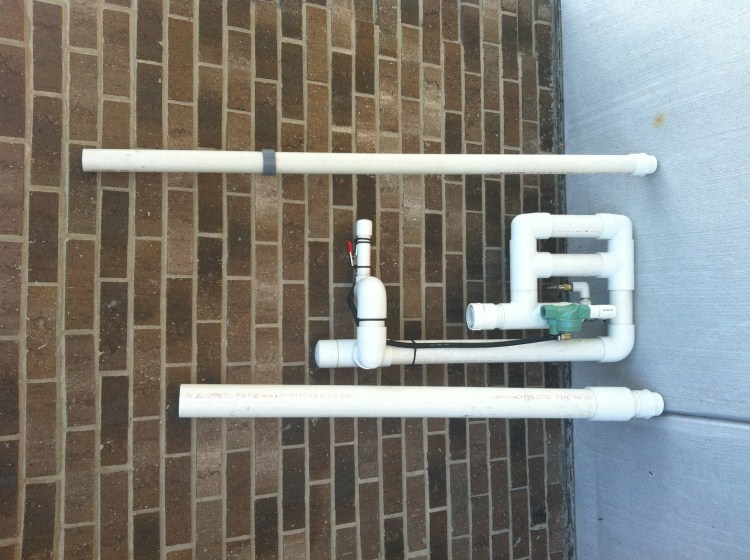

Entire gun
Entire gun
Left side and both barrels
Right side and both barrels

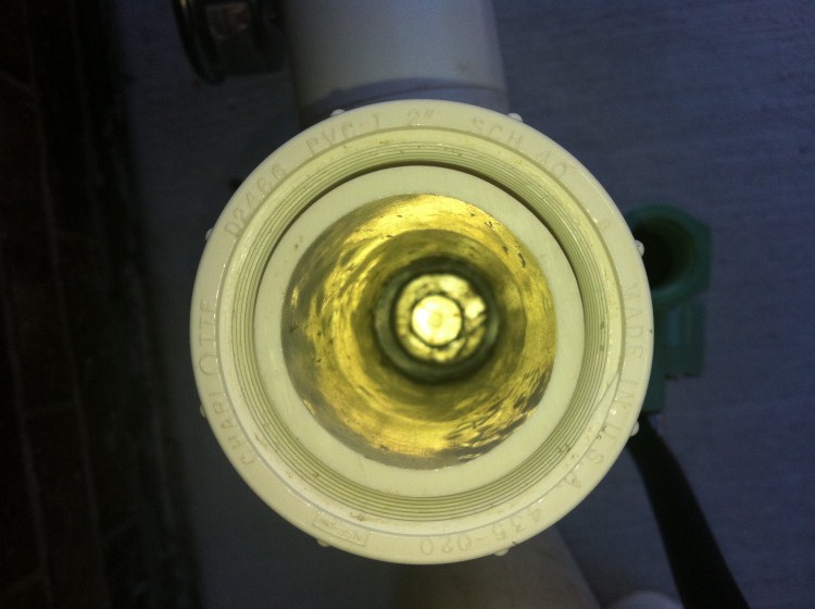

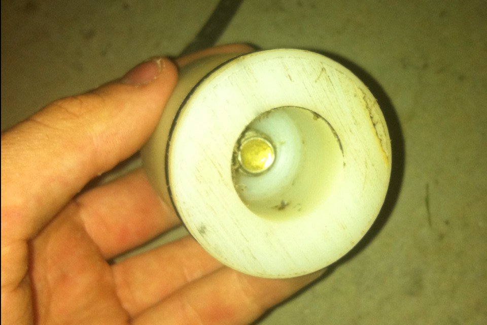

Piston face (my camera hates focusing on what I want it to) I would take out the piston but I just tightened everything up, nylon piston with half a tennis ball bumper

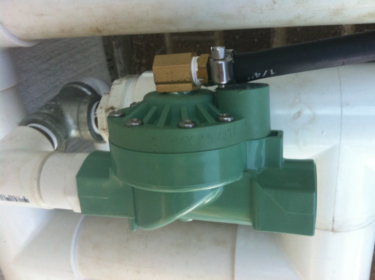

Modded Orbit 3/4" sprinkler

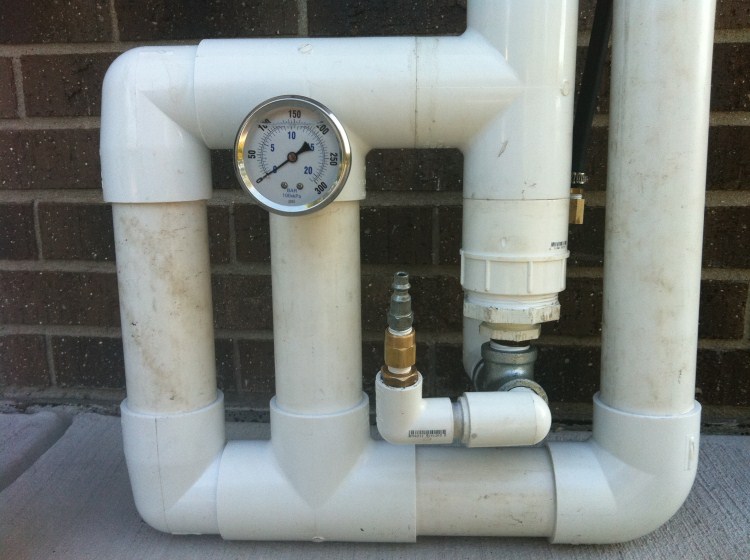

Pressure gauge and quick disconnect

Back of piston bored out to save weight
Equalization hole
Equalization hole

Figured that while I had the gun apart to make the repairs (just need a PVC tee, should be done tomorrow night) I would post some pictures of my piston.
Edit found better photo
Camera trick. Move the camera away from what you want by the distance it is improperly auto focusing. For example if it is focusing on the end of the pipe, let it. Half press the shutter to lock the focus, and move the camera back closer so it focuses on the desired piston, then finish pressing the shutter. Many of my QDV piston and port photos were taken that way.
Sample photo taken by focusing on the end of the pipe and then moving the camera in close to move the focus to the piston.
