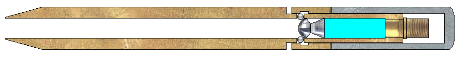

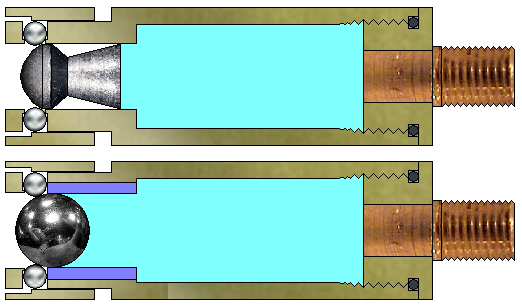

And how would you charge it if you have to have that cap on to hold the ball in place?

The cap seems to be in two parts... the brass one holds the ball while the aluminum one is just an extension.

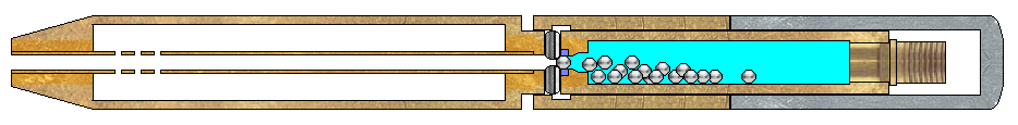

I love the full auto one but I doubt you'd get more than 3 shots off. Still... Full auto pengun, cartridge pengun, valveless pengun, oh the things JSR can build with Sherline
Well spottedFighterAce wrote:The cap seems to be in two parts... the brass one holds the ball while the aluminum one is just an extension

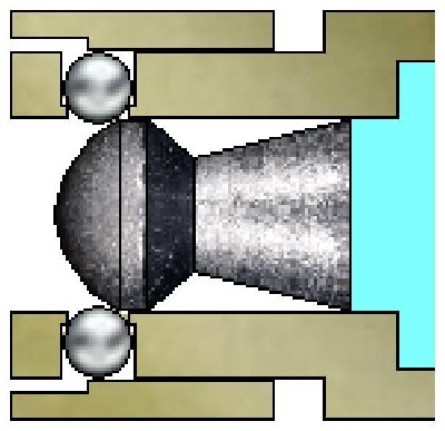

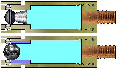

A slightly modified cartridge version, with a removable rear cap. This would allow either the skirt of a diablo pellet type projectile to be flared against the walls to provide an effective seal, or a silicone sleeve to be inserted that would seal a hard projectile like a steel ball.

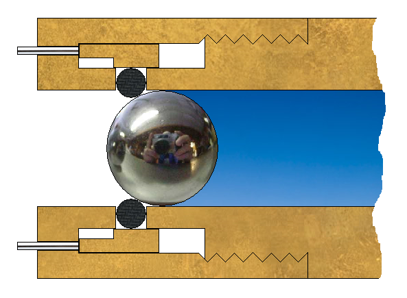

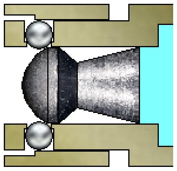

Jsr is there any way you can think of making the detent out of an oring rather than ball bearings, because that would eliminate the need for another seal. The only problem is I can't think of a way to hold it in.
Use a thick o-ring and recess it far into the walls?
Problem: Upon firing, those ball bearings are just going to fall out of their goove and be blown out the barrel with the projectile...

he thought of thatInsomniac wrote:Problem: Upon firing, those ball bearings are just going to fall out of their goove and be blown out the barrel with the projectile...
I've been thinking about that for a while, it's not an easy proposition. Here's one way I had though up but it's too complex for my liking.Gun Freak wrote:Jsr is there any way you can think of making the detent out of an oring rather than ball bearings, because that would eliminate the need for another seal. The only problem is I can't think of a way to hold it in.
