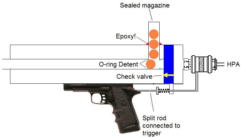

I had a random thought :idea: to use a QDV to pilot a coaxial gun and it just kinda ran away from me. :D It's a little simplified but using paint to make really complicated pieces isn't easy at 3 am. :lol: Any thoughts?
Coaxial custom.JPG (33.86 KiB) Viewed 4411 times
It would work as drawn but a slide valve pilot would be easier to put together and much more efficient too as the HPA feed is blocked off during firing.

What about a 3 way instead?
And then have a rod that comes from the trigger and pushes the button.
LovableAirGuns wrote:And then have a rod that comes from the trigger and pushes the button.
A slide valve in this case is a three way valve ;)

jackssmirkingrevenge wrote:It would work as drawn but a slide valve pilot would be easier to put together and much more efficient too as the HPA feed is blocked off during firing.
What are you using to block the flow of HPA through the slide valve? Its my understanding that the slide valve is just a pass through which has the ability to vent the pressure inside it to atmosphere. There would be nothing to stop the HPA from flowing out of the slide valve while firing from the HPA source unless a separate cut off valve was used... just trying to understand the drawings, sorry.

The slide valve is a three way valve, it shuts off the HPA when triggered.
c9d wrote:What are you using to block the flow of HPA through the slide valve? Its my understanding that the slide valve is just a pass through which has the ability to vent the pressure inside it to atmosphere. There would be nothing to stop the HPA from flowing out of the slide valve while firing from the HPA source unless a separate cut off valve was used... just trying to understand the drawings, sorry.
Again:
When the valve is in the forward position, it allows air to flow from the main supply to the QEV and fill the pilot and firing chamber.
When the valve is in the rear position, two things happen:
- main supply is cut off
- QEV pilot chamber is open to the atmosphere, emptying it and firing the launcher
The valve goes back to the forward position (you need to add a spring or do it manually) and the cycle can be repeated.

I think I'll try to build that slide valve. I figured with a restriction on the flow it would slow it down enough for the QDV piston to close. I never was one for finding the most efficient way to do things. :lol: I'll give it a go though.
