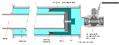

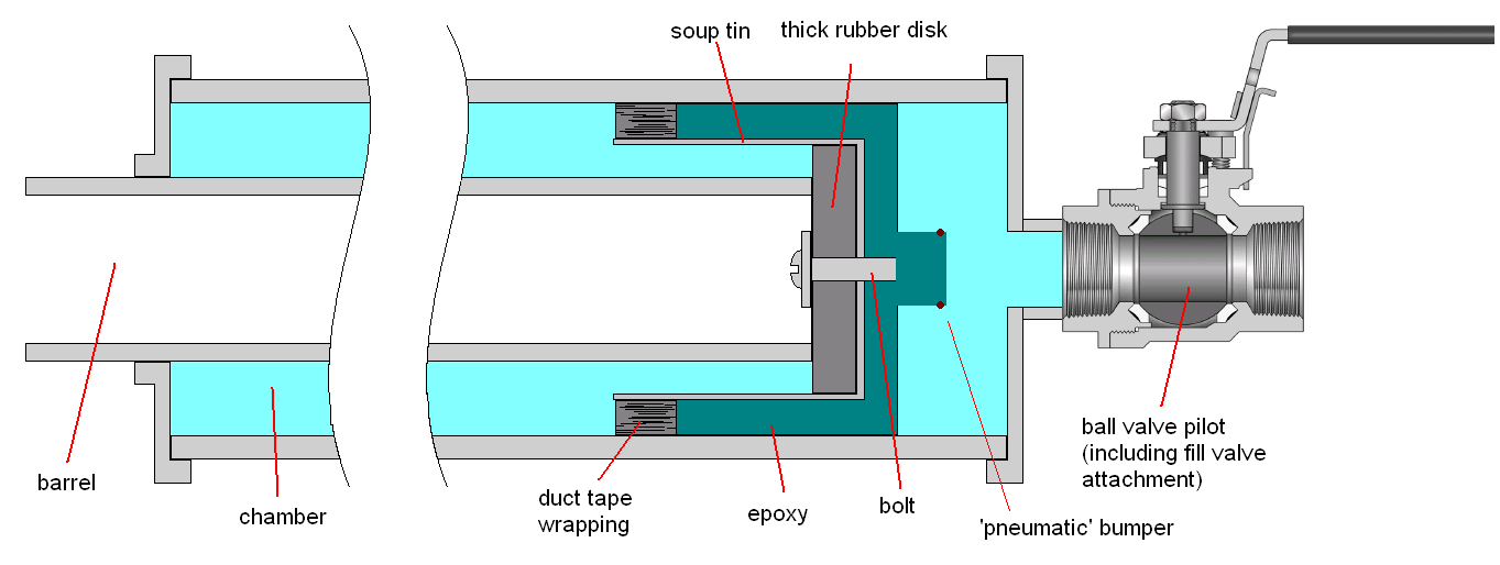

quite familiar with the design and it's a great and simple idea.
Alright guys, I think I have a pretty good idea, of how it will look.
A few things I'm unsure of are what material to make seal on end of piston out of. Just a round rubber disk?
If barrel is 2" diameter and chamber is 4" diameter should make disk 3"?
When bolting rubber on, should I seal it with epoxy or loc-tite to make sure it doesn't leak?
If piston diameter is going to be 4" how long should piston be? I have heard it should be as long as the diameter. I am going to use a cup design as JSR suggested.
I liked the idea of the bumper, on the end of chamber piston is going to hit I am going to have a 4" to 2" reducer and a 2" - 3/4" reducer so it will taper down and I am unsure how to make the bumper. I just have a rubber seal that is same diameter as the piston? Thanks guys.

To actually build POLANDs bumper you could just use a much longer bolt to hold your sealing face on. With the extra bolt threads coming out the back of the piston, you could use some washers and an o-ring to seal it off. I'm kinda bad at explaining, but I could draw it if you'd like
