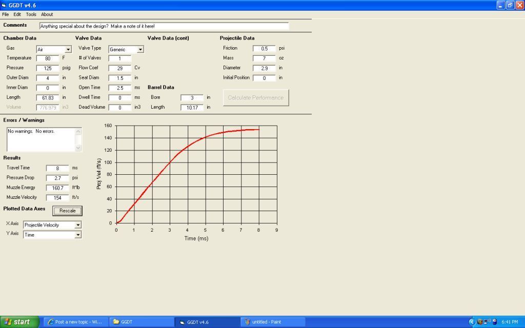

I am designing a water balloon launcher, and am trying to calculate the optimum C:B Ratio for a gun with 72" length. I am using a 4" aluminum pipe for chamber and a 3" aluminum pipe for barrel. I am using a 1.5" solenoid valve with a CV of 29.
I am just surprised by the c:b ratio recommended. I am not sure if I entered info correctly, especially in the valve section. Any help is appreciated. Thanks
Working on getting it pasted in forum, thought I did but can't get it to upload

Why does GGDT give low FPS result with a faster valve open time? I was thinking maybe it meant how long the valve is open, but that's cant be the case either since setting it high also kills FPS.
The problem with the low FPS is the dwell time. Try again with a dwell time of at least 20ms. It is simulating a hammer valve which opens for 2.5ms and is closed again due to no dwell time. The air in the barrel continues to expand and the power rapidly drops off early.

I ran a calculation using a burst disk of 1.5" and a CV of 29 and got a totally different suggestion. Said to use a 21" 264cc Chamber and a 51" 360cc barrel. Totally confused.
Dwell time on a burst disk is > one second. Once open, it remains open. :D

So when I change the dwell time, it says "ms" for the units of measure, guessing milliseconds. So wouldn't a solenoid valve remain open until the gas vents the chamber so wouldn't it be the same as a burst disk for this?

After running some calculations on GGDT it calculated that the optimum barrel configuration for a gun with a 3" barrel and chamber would be a 24" chamber and a 48" barrel @ 125psi. I thought that the general consensus was the opposite for pneumatic guns.

GGDT doesn't optimize the lengths by performance. Rather by efficiency. At a certain point, a larger chamber starts to give back not as much gain, and this is where GGDT cuts it off. Making the chamber larger, however, will still give you much better performance.
