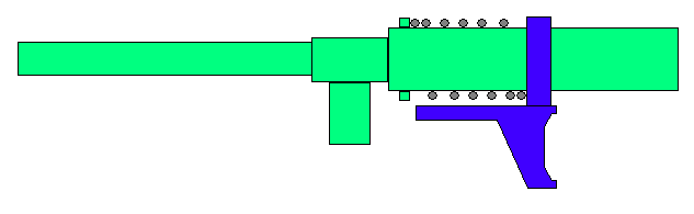

I was doing some research last night on how to do the recoil absorpotion system. I some some linear rail systems that were over $150. I'm sure there is a more economical way to do this. I am trying to make this gun look as nice as possible so any ideas would be appreciated.
I think I am going to focus of recoil absorpotion system first and then look into suppressor. The fact of muzzle brake increasing noise makes me want to fire gun first, figured this would be an easy addition

you could use a shock absorber from a small mountain bike might need to put a lighter spring on it

Here's a basic idea of what you should be aiming for, green is the barrel-valve-trigger-chamber, purple is the part that rests on your shoulder and grey is a spring.
It's unlikely you'll find a coil spring that big that won't be too stiff, but as I said, the spring can be replaced with a gas strut that can be found reasonably cheaply on eBay or from your local automotive outlet, bungee chords or slingshot elastic are also a viable solution.

make the gun as heavy as possible - that will reduce the recoil
I see, I am gonna wait and see how bad the recoil is then decide on what to do. I was originally trying to weld a track system to the bottom of the chamber and have a single gas strut.
Not sure if that would work since it would not distibute force evenly.
