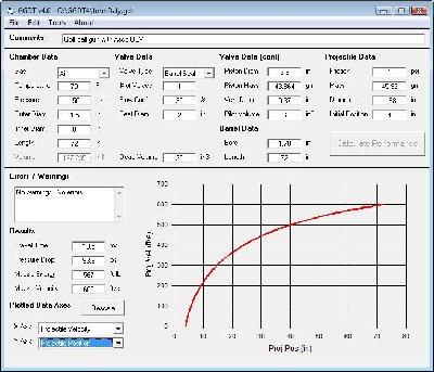

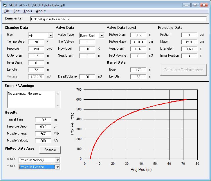

Done. Note that the valve efficiency is lower than one would normally expect due to the fineness of the reservoir. In other words, the tightest spot for flow is in the valve's inlet, not the valve itself. This was a sacrefice due to ergonomic concerns. I suspect I could get another 5-10% efficiency out of the valve if I had a larger diameter reservoir feeding the gun.dewey-1 wrote:Could you post a screen shot of your GGDT parameters for this valve?
http://www.spudfiles.com/forums/dd1wood ... 17514.html

Hate to kick up a old thread, however Dewey and I were in discussion, and My question to to you, DHall, is how far is this cannon capable of putting a golfball? I am not familiar with ggdt yet, however I would think it would be capable of greater than 400 yards??
Go Bruins!!!!
Matty look up and see that he posted a screenshot of valve parameters in case you missed it.
