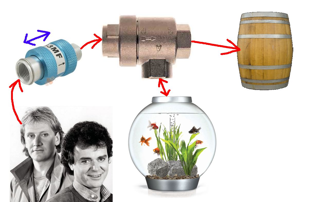

A slide valve has two positions, for the purposes of this conversation we will call them "unfired" and "fired"
A standard slide valve has no bias towards any particular position. In order to be used as a "conventional" trigger it needs some modification.
You basically need a return mechanism (coil spring, rubbar band, trained beetles etc.) that will keep the valve in the "unfired" position when you're not touching it.
You also need to attach some sort of... well, trigger - to the slide part, otherwise it's quite inconvenient to use.
Have a look at this fine example by Lockednloaded.
Plus what are the parts used in this creation? (I see a ball valve, chamber, trigger, etc but i can't see how the trigger works)
All you need is QEV and slide valve. The slide valve is the trigger, but as I said it needs some sort of trigger mechanism fabricated in order to have it function ergonomically.
You obviously also need to connect a chamber to one side of the QEV and barrel to another, and an air supply to the slide valve.
edit: pictoral guide :D
