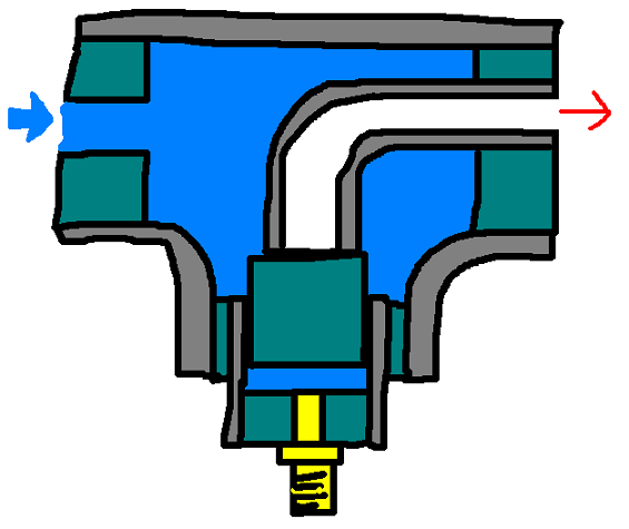

The sprinkler configuration may be able to be made with mainly standard parts and epoxy. I was considering putting a smaller diameter elbow inside of a larger tee much like BtB did for his unregged BBMG

Lockednloaded wrote:I was considering putting a smaller diameter elbow inside of a larger tee much like BtB did for his unregged BBMG
This is how I picture it using standard parts and epoxy, lots of turbulence though *cough*diagram fixed*cough*

warhead052
Posts: 1769
Other way jack, your arrows are going the wrong way. It wont work like that... Unless I am missing something.
Been thanked: 350 times
Right you are, as it was would have made a great pop-off valve ;)
Fixed.

jsr wrote:untitled.png
That's what I was thinking, except with a rubber diaphragm with a metal washer for support. Does anyone know a good way to drill through solid rubber?
