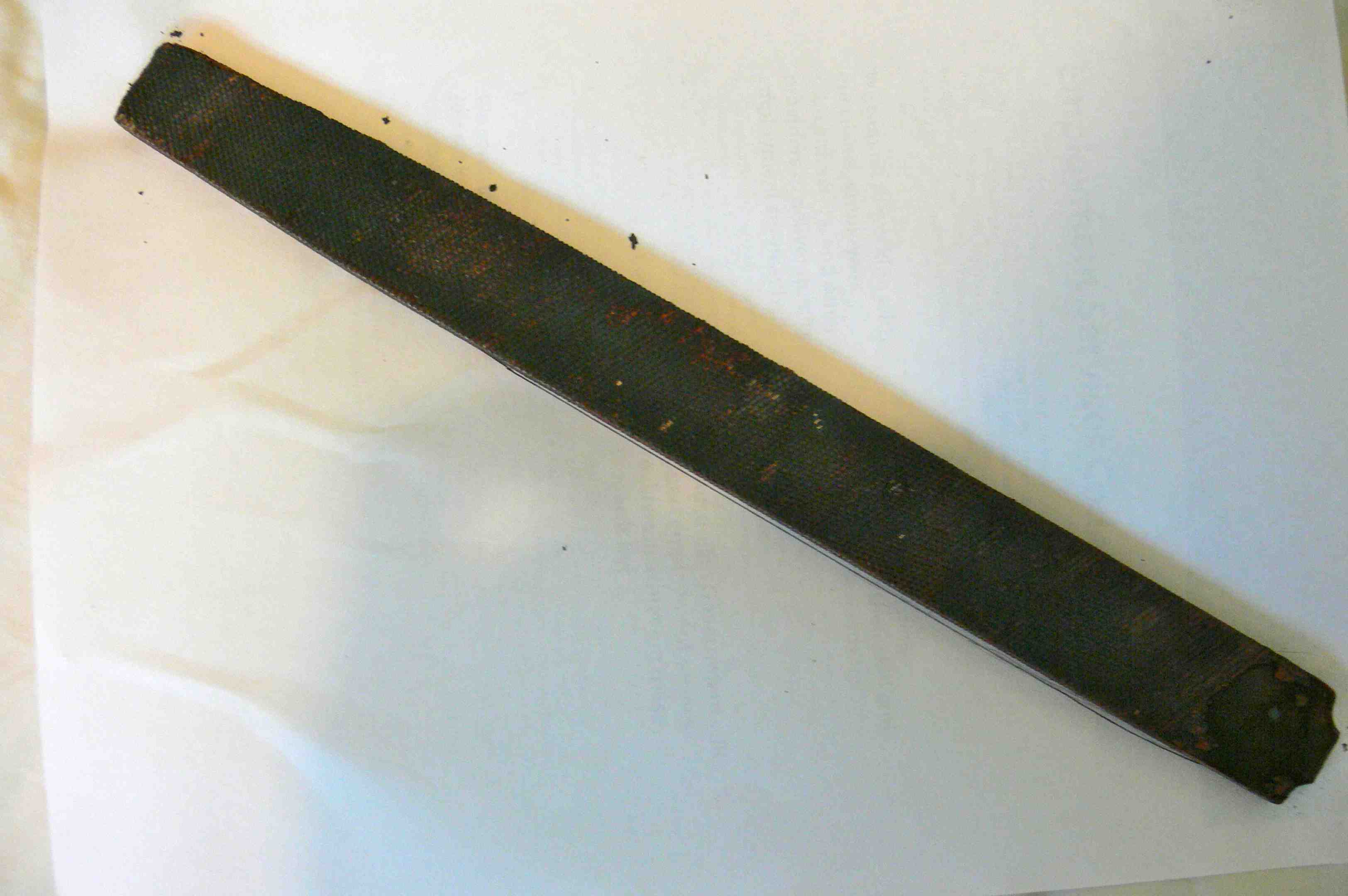

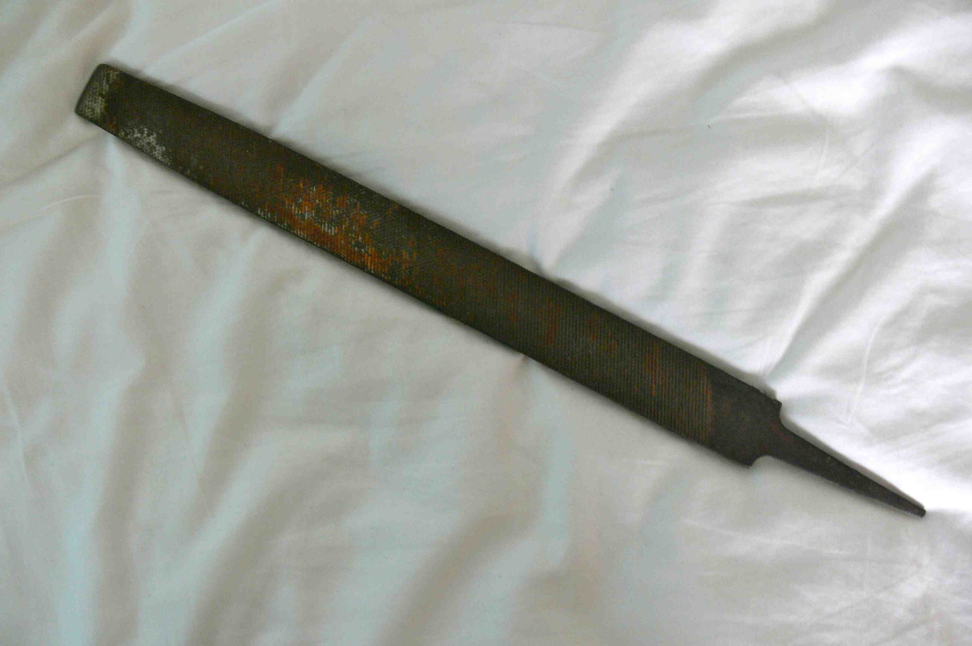

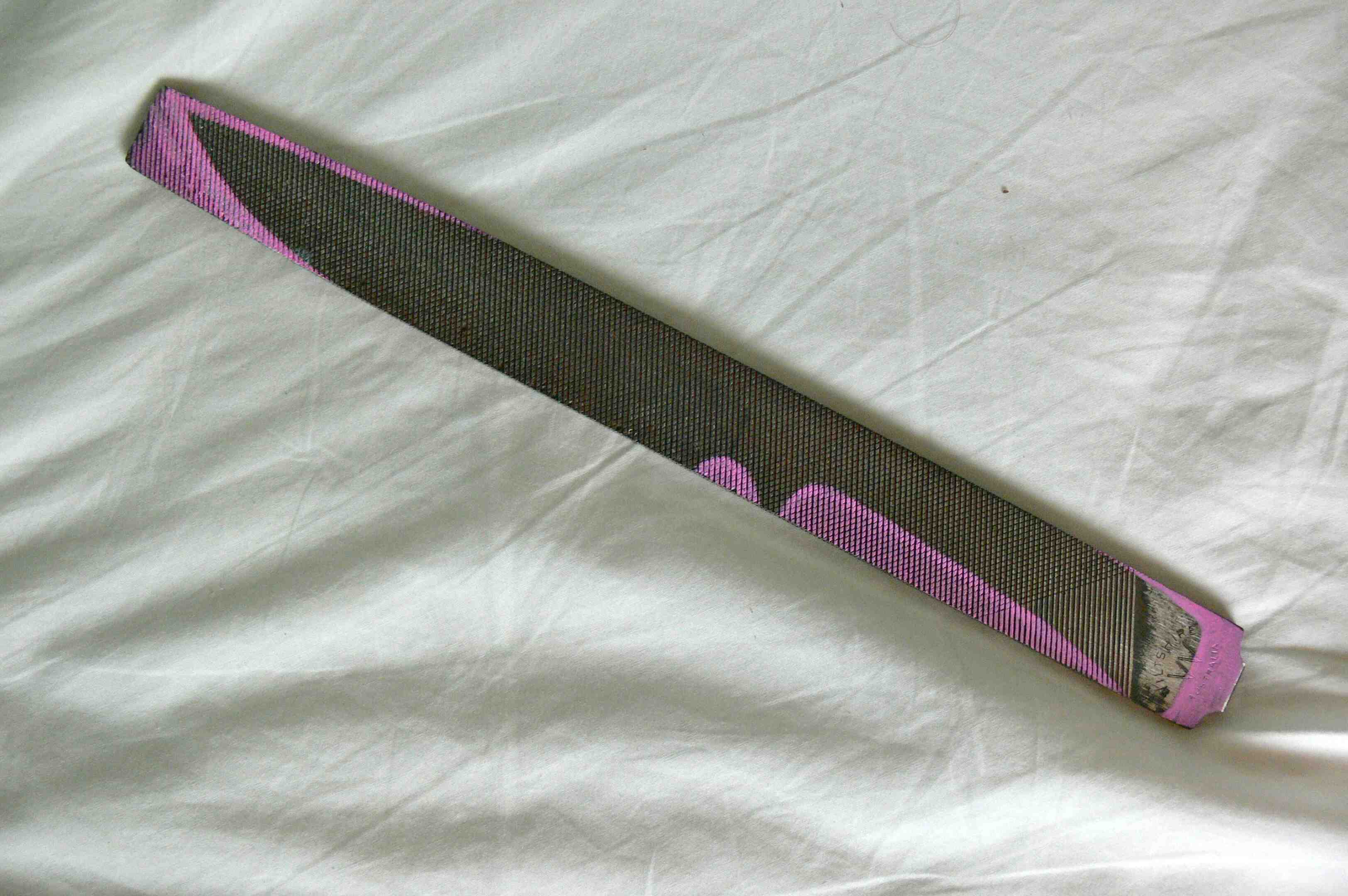

just thought i would show you what i have done so far on my knife that iv started making out of a file
not going to go into much detail just yet, if you have any questions/tips i would love to hear them, anyways here are some pictures of it so far
Edit: or going by the order of the photos, this is how i made a file out of a knife -_-
file knife (in the making)

looks bloody great man, what did you use to use to grind the blade?
the file pattern make it look like carbon fibre.

That looks *really* good!ilovefire wrote:just thought i would show you what i have done so far on my knife that iv started making out of a file
I hope you leave the original file markings, it's a brilliant effect!
lololor going by the order of the photos, this is how i made a file out of a knife -_-
always upload in order that you want them to appear.
cheers, so far iv just been using an angle grinder, but theres still a lot to go and am thinking i might try a belt sander to get it nice and evenCrna Legija wrote:looks bloody great man, what did you use to use to grind the blade?
ha ha funny you picked that up because i was thinking the exact same thing just before i posted thisCrna Legija wrote:edit: lol kinda contradictory of your sig.
thanks, and yes, i will be leaving the markings, and have even got some of them on the back of the bladejackssmirkingrevenge wrote:That looks *really* good!

ill keep that in mind for next timejackssmirkingrevenge wrote:always upload in order that you want them to appear.

not exactly sure how long that took must have taken a couple hours or so, then add a few more to that to get it to where it is nowGun Freak wrote: how long did it take to do that much?
good ideaBrian the brain wrote:You could still launch it you know....
i have pretty much got it ready for heat treating now, just have to drill some holes inn the handle for the rivets that will hold the grips on.
dosent really look much different but i still got a couple more photos for you's
