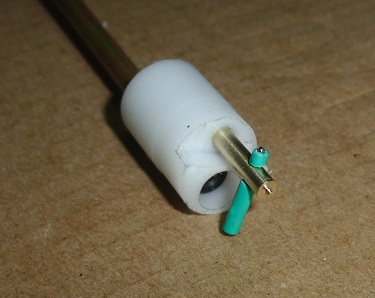

Put it on hold for now, a bit fiddly in the dimensions I chose. Started on something else in the meantime, trying to see if the Monsoon loader will work at lower pressures, watch this space
I started on this but realised that my smallest o-ring for the blocket piston wouldn't fit, so I have to remake it with the barrel mounted off-centre.

I recently made another prototype based on the above, with the benefit of the lathe, but no real luck, it either cycled extremely fast or not at all, though by restricting the outlet with my finger it was popping away quite happily
The problem of projectile feeding remains though, you still have to hook this up to some sort of reloading breech.
Well it sort of works... testing at 850 psi:
I have a feeling cloud feeding is never going to be reliable enough...

what if you used an inline vortex block and had a bolt portrude into the barrel partly, and used some sort of linkage to link it to that spring piston? That way you eliminate the cloud feeding..
I feel like the linkage could be somewhat difficult to implement however..

It might be worth just replicating the airsoft "bullet valve" upping it to HPA:

Did better than I expected... The fact that it's a cloud makes it automatically unreliable.
I would be a shame to let go of the detent though.
