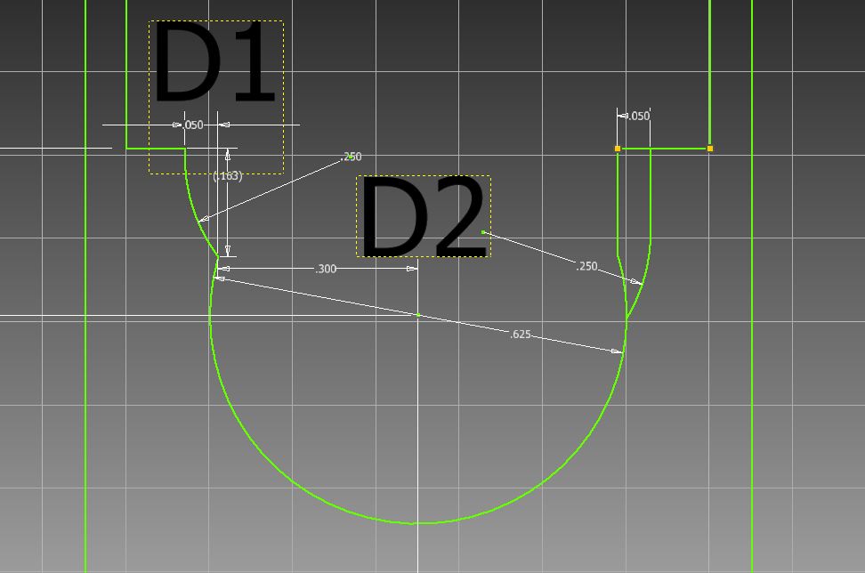

all right, more questions. the drawing seems under dimensioned. are these assumptions accurate?
assumptions.zip
(166.96 KiB) Downloaded 169 times

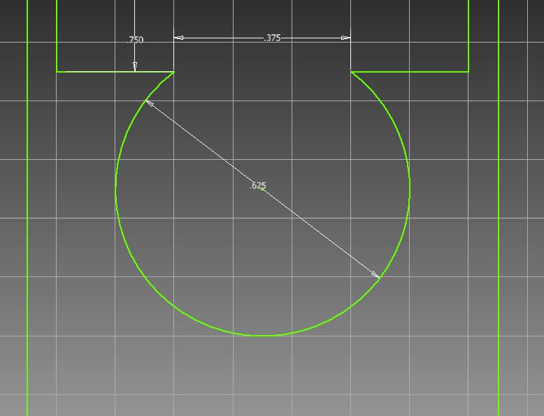

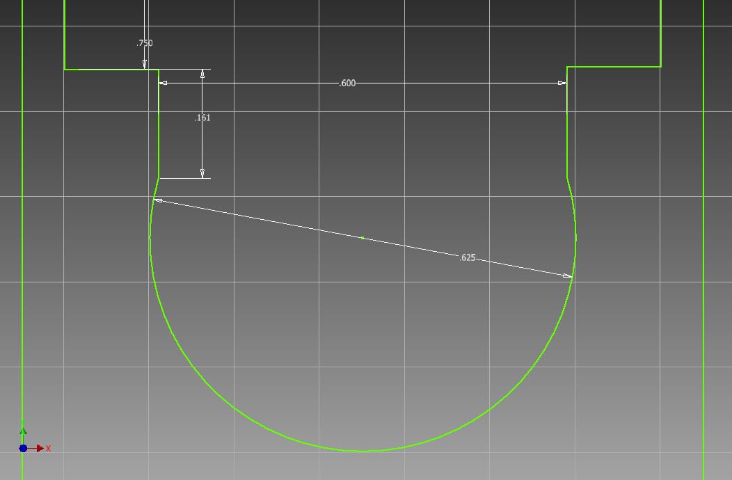

Some options (These are wanna be section views):
And yes, the drawings are a mess :oops:
With ball end mill. Right side is tangent to the .625" hole.
"Normal" end mill, square corners, possibility of square top view corners
The way it is now.
The way it is now.

Thanks for the clarifications ramses, lets go with a normal end mill square.
